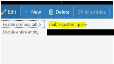

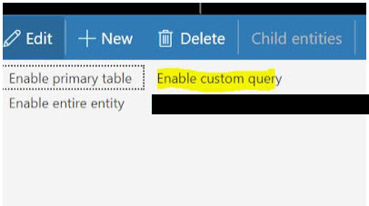

And then go to Data Entities -> Filter the entity (WMSLocation) -> Change Tracking -> Enable Custom query.
