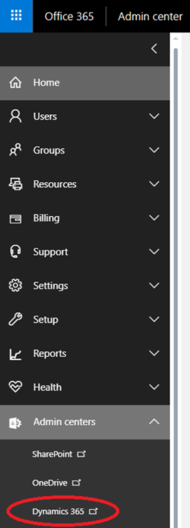

Step 3
On the Admin Center page, select ‘Admin centers’ using the navigation pane on the left side (you may need to scroll to the bottom) and select “Dynamics 365” from the list. This will take you to the Dynamics 365 Administration Center.

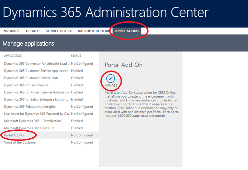

Step 4
Navigate to the Applications tab in the Administration Center. From here you would need to select Portal Add-On and then select the Manage button.
