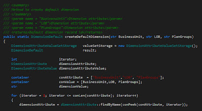

Please see below screenshot with source code explanation.
Explanation of source code (1.1):
  • In this section of Job Main method I have called the createDefaultDimension Method.
  • In this method I have passed three dimension attribute values.
Explanation of source code (1.2):
  • createDefaultDimension Method with three argurments.
  • Initialization and declaration of classes and data types.
  • Pass argument having dimension values and store into container.
  • After container is filled with dimension attributes and its values, iterate it.
Explanation of source code (1.3):
  • Iteration of dimension attributes.
  • Check dimension attribute exists or not.
  • Get the dimension attribute value.
  • Add the values of dimension in value Set Storage class by using add Item method.

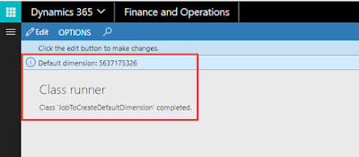

Result:
Run the class (Job).
That is all you need to do to create default dimension record Id.
