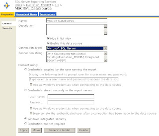

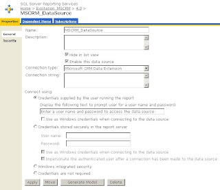

All CRM reports with SSRS are configured to use a specific SSRS Data Source. When the Connector is installed, the Data Source is changed to use the MSCRM Data Processing Extension, instead of the default SQL Server extension. See images below:
Report properties showing the MSCRM Data Source
MSCRM Data Source using the SQL Server extension before the connector is installed
MSCRM Data Source using the CRM extension after the connector is installed.
There are 3 differences between these configurations:
  1. The Connection Type, which specifies the extension
  2. The Connection String is absent with the CRM connector. This is because the connector reads some of the database information from registry values that were created during its installation, and some from data passed to it when the report is run (see below)
  3. The Credentials. With the SQL Server connector, standard Windows Integrated security is used - i.e. the user's AD credentials are used to connect to SQL Server. With the CRM connector, separate 'credentials' are passed to SSRS (again, see below)
