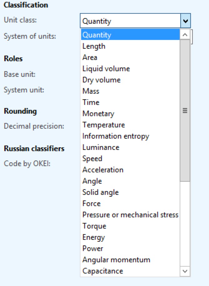

Once I create my new unit, I have to select the Unit class. Below is a portion of the Unit classes available for selection:
A screenshot of unit classifications such as Quantity, Length, Area, Liquid volume, Dry volume, Mass, Time, etc.
Some of the many classifications available for the creation of Units in AX.
I am going to select Mass as the Unit class for my new unit Carton. Then I select None for System of units since this is a unit that is specific to my company and doesn't fall under the systems available. System of units is where we define if the unit is Metric or United States customary. This is not a requirement for the unit to function properly.

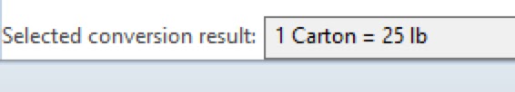

Unit conversion setup between Carton and lb
As you can see in my example above, I set it up to read as follows:
Screenshot closeup of unit conversion formula 25.000*(1/1) from unit Carton = to unit lb
The conversion formula appears to be set up backwards, but if you look at the conversion result at the bottom of the screen, it does read 1 Carton = 25 lb.
Our conversion result shows that we can now switch between 1 Carton and 25 lb easily when this conversion is set up on an item.

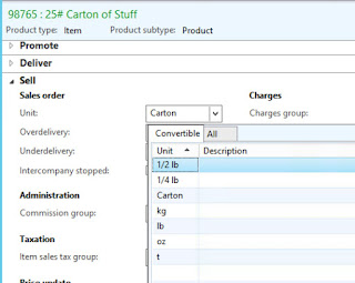

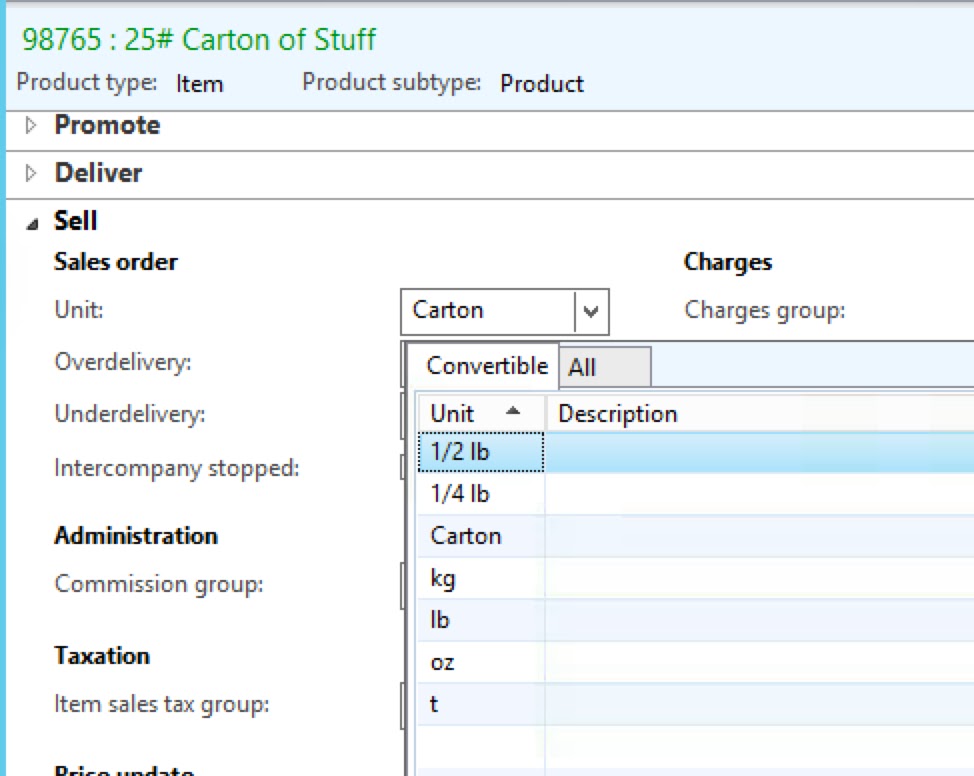

Now, I can go back into my item and set my Inventory UOM to lb and my Sell UOM to Carton. It will work seamlessly between the two, with the carton always weighing 25 lb due to the conversion.
Screenshot showing Carton as an available unit for our item where we created the conversion.
Carton is now available as a selection for Unit on my item where the conversion was created.
As you can see, Carton is now available for me to choose on my item for my UOM fields because there is a valid conversion between the two items. I can choose to sell my item by the carton and inventory it by the lb or vice versa.
