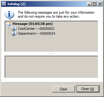

The same result can also be achieved using "DimensionAttributeValueSetStorage" class.
DimensionAttributeValueSetStorage dimStorage;
ProjTable ProjTable;
Counter i;
ProjTable = ProjTable::find("10005"); // To display value for ProjectId "10005" only
dimStorage = DimensionAttributeValueSetStorage::find(ProjTable.DefaultDimension);
for (i=1 ; i<= dimStorage.elements() ; i++)
info(DimensionAttribute::find(dimStorage.getAttributeByIndex(i)).Name +"----" +dimStorage.getDisplayValueByIndex(i));
Here is the result for the above piece of codes.

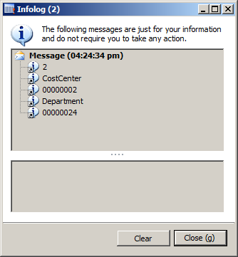

The same result can also be achieved using "AxdDimensionUtil" class.
Counter i;
container conDim;
conDim = AxdDimensionUtil::getDimensionAttributeValueSetValue(ProjTable.DefaultDimension);
for (i=1 ; i<= conLen(conDim) ; i++)
info(conPeek(conDim,i));
By using this code we get a slightly different result.The first line shows the no of dimensions associated with the entity while the rest of the lines show the dimension name and their respective values associated with the entity(Project).
