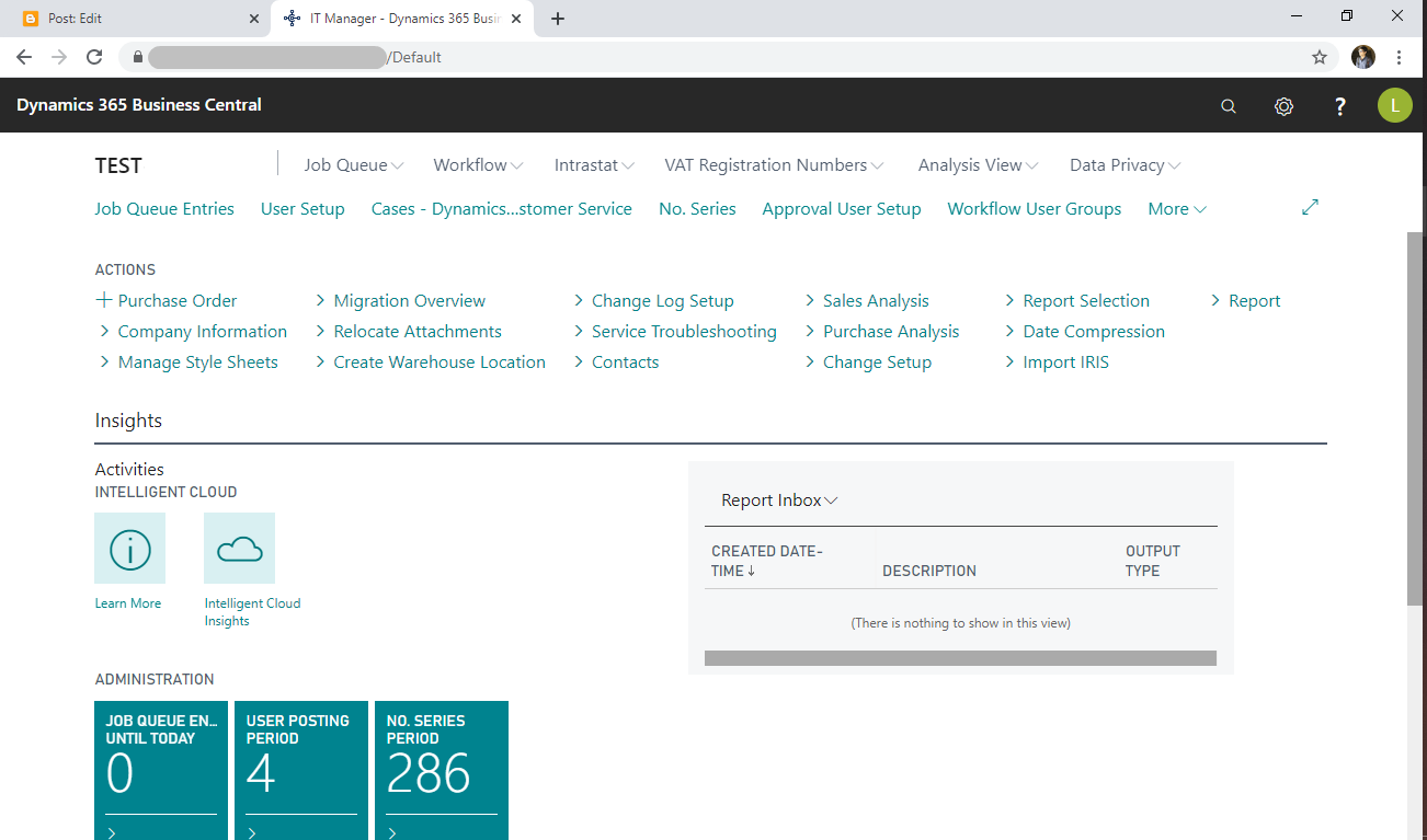

Simply login into your Browser with the Web Client URL
Business Central - Web Client
Select the LS Retail Role

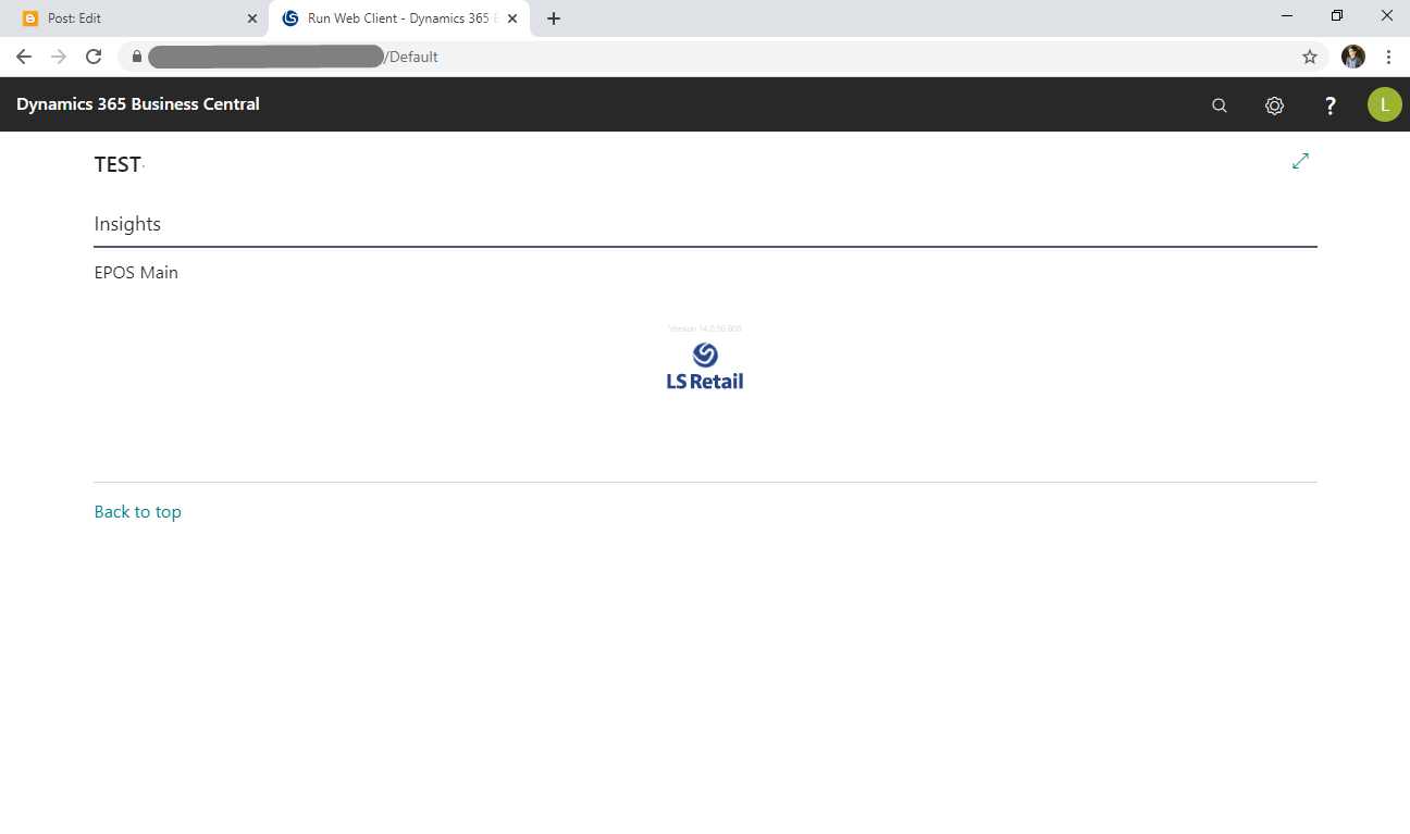

Once, you have selected the correct Role, automatically your Business Central session will refresh and will initiate LS Retail Web-POS
LS Retail - Web POS Initializing
