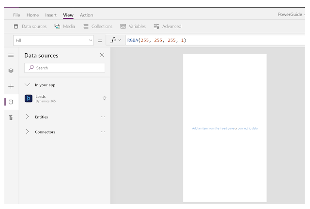

Step 1: Create a Blank Canvas App > Connect with Dynamics 365 Data Source > Connect with Lead Entity

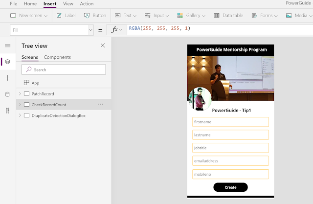

Step 2: Add few Text Inputs and Button Control to design the Screen for Lead Creation

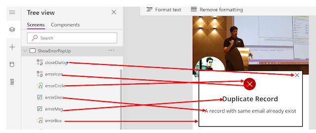

Step 3: Add few Controls like Labels and Icons in order to design Popup/Dialog Box.

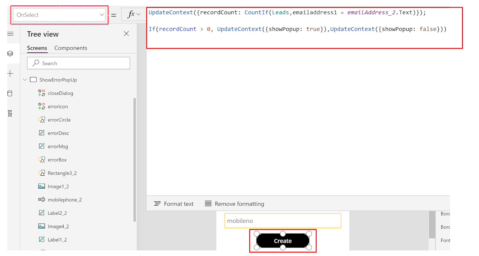

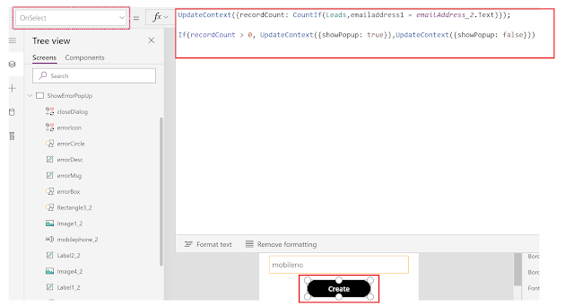

  2. OnClick of Submit Button, Check if lead of entered emailaddress already exist in D365, if Yes, then Set Popup/Dialog Visibility to TRUE else FALSE.

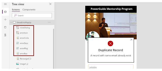

Note : Here Popup/Dialog is the Collection of various Controls that we are using to design the Popup/Dialog. That means, hiding the Popup/Dialog means you'll have to set all the controls Visibility to FALSE that has been used to design the Popup/Dialog and Showing the Popup/Dialog means you'll have to set the same controls Visibility to TRUE.

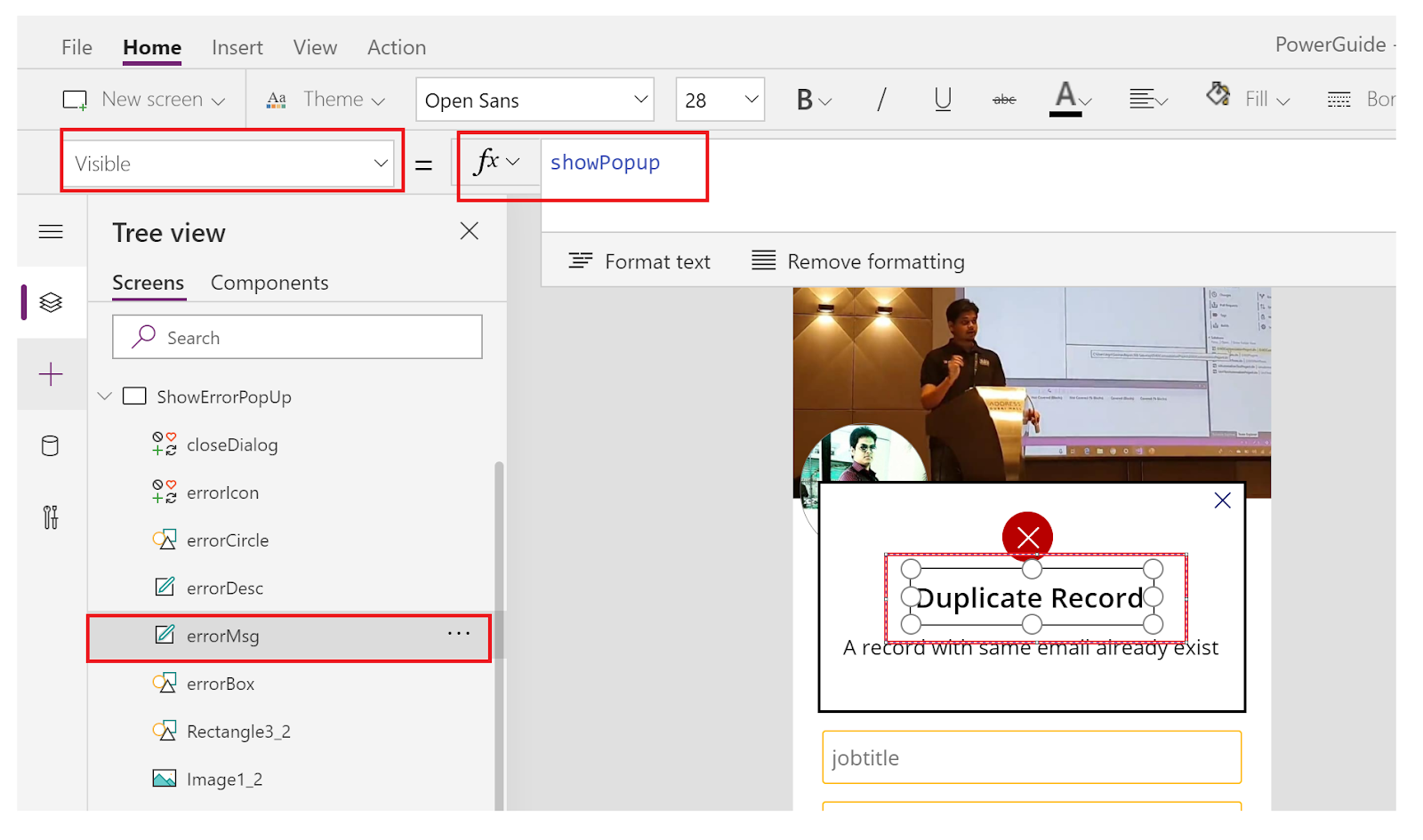

Keep all the Popup/Dialog Box Controls Visibility to False on Load of Screen
If Lead of same emailaddress already exist, then Set Popup/Dialog Box Visibility to True else False
Set Variable to Popup/Dialog Box Control's Visible Property. In above screen, I have set Variable to only errorMsg label (as shown in highlighted screen). However, you have to do the same for all the Controls that you are using to design the Popup/Dialog Box
Step 5: Set Visibility of Popup/Dialog Box Controls on Button Click.
