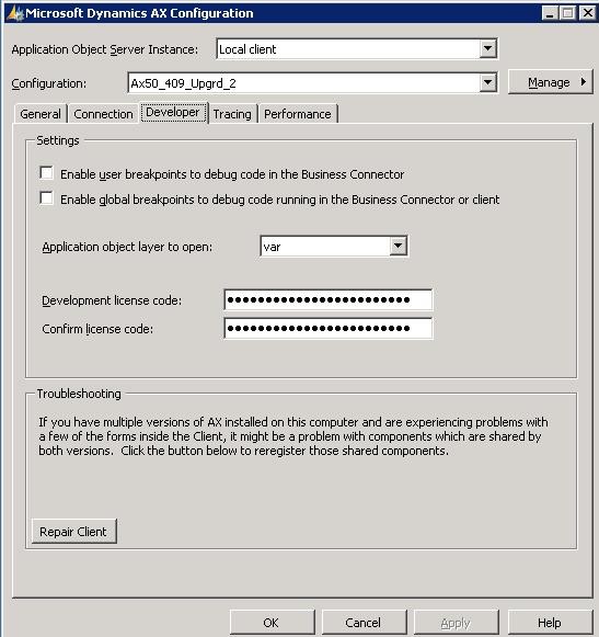

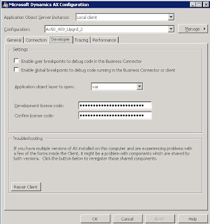

If you have modifications on more than one layer, upgrade layers one by one. You should start with the lower layer first. For example if you have customizations on BUS and VAR, upgrade BUS layer first then VAR layer. - Close Ax 2009 and open it again in the layer you are going to upgrade first. For example, to upgrade VAR layer you need to have Ax client configuration setup with VAR development code.

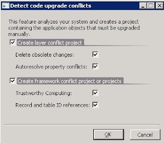

- In Ax, run Microsoft Dynamics Ax--Tools--Development tools--Code upgrade--Detect code upgrade conflicts.
This tool analyzes customizations for code upgrade conflicts and creates one or more upgrade projects.
It will create a private project for conflicting objects, called *LayerConflicts. Inspect the conflicts in the Layer Conflict Project. Resolve some of the conflicts using the compare tool. Rerun conflict detection and check if the number of conflicts decreased. - Compare Layer tool can be used as an alternative to Detect code upgrade conflicts tool. Run Microsoft Dynamics Ax--Tools--Development tools--Code upgrade--Compare layers, to compare any two layers and create a project with the objects that differ. The Compare layers tool can provide an overview of modifications made in a certain layer.
