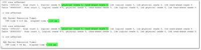

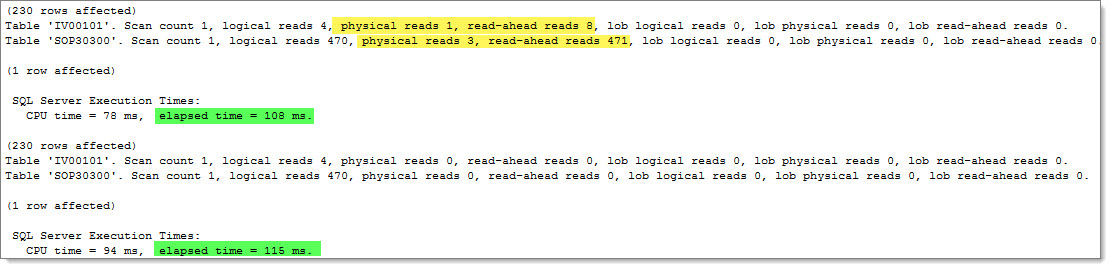

My assumption was that the subquery would be noticeably slower than the JOIN.
To my surprise, the two queries had effectively the same cost and performance.
Interestingly, there are more reads for the subquery version, but the performance is effectively the same--in fact the subquery was slightly faster in this test.  This is not what I expected.

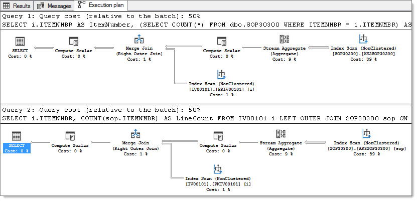

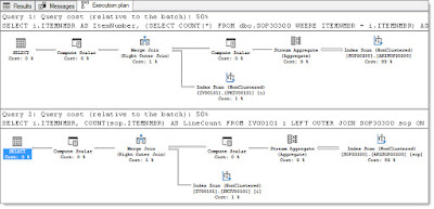

Take a look at the actual execution plan.  Take a good, close look.  What do you see?
I am sure that the first few times I ran the two queries, there WAS a difference in the execution plan, but it still showed a 50%/50% for the two queries--effectively the same cost. But after several runs, I now consistently see the exact same query plan for both queries.  The EXACT same query plan.
WHAT?  This is absolutely not what I expected.
And after running the query a few more times, the statistics are now always identical.  I'm afraid the machines are learning.
So...what does this mean?  Well, I wouldn't call this a universal rule, but, for a simple query, on SQL Server 2014 SP1, with a relatively small result set, it appears that SQL Server is able to figure out that the two different queries are effectively the same, and after running the queries a few times, SQL uses the exact same execution plan for both queries.
