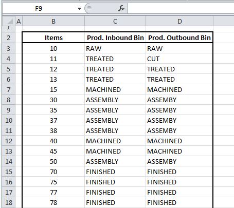

The task was to do a onetime mass update to the item records. There were more than 85.000 items in the company and they all had two production bin fields that needed to be updated according to a table with some rules provided in Excel. For items starting with ’10’ the two fields should be ‘RAW’ and ‘RAW’, for items starting with ‘11’ the two fields should be ‘TREATED’ and ‘CUT’, etc. like the below table, nothing strange.

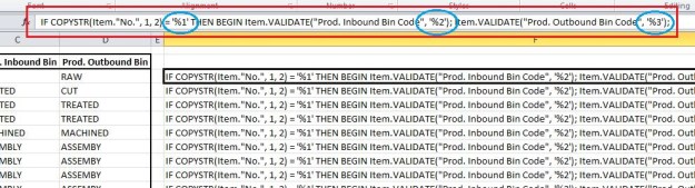

Add the code for the IF statement with the modifications to the records in a cell in the Excel spreadsheet and where the item number part and bin codes are put something that can be replaced by Excel. In the case below I used ‘%1’, ‘%2’ and ‘%3’ (why not use some NAV syntax :-)).

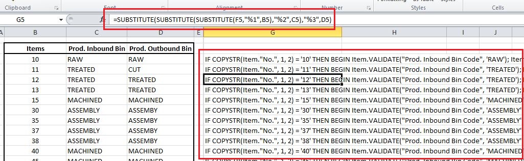

Then in another cell in the Excel spreadsheet, create a formula and use the SUBSTITUTE function three times to replace the ‘%1’, ‘%2’ and ‘%3’ with the item number parts and bin codes. This then creates the proper C/AL code for the IF statement, just drag it down and you have all the IF statements you need.

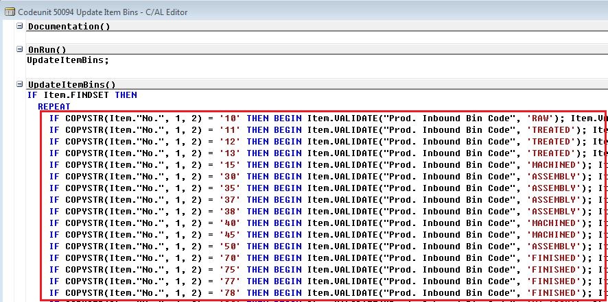

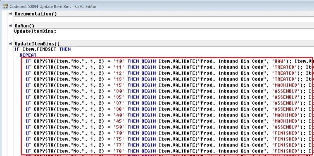

This can then be copy/pasted into Dynamics NAV and placed within a loop like below (or place it a report).
CAL-Code-Copied-From-Excel
Agree, it looks a bit weird to have the IF statement, the fields and the MODIFY statement all on the same row, but since this is a onetime update to the records it is less of a problem. Since we now, starting in version 2013, can have 240 characters on a single line of C/AL code this approach could be very useful.
Then it is just to run the function and all the records gets updated.
