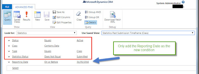

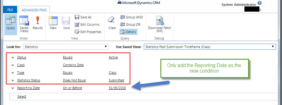

You can also try to tweak your code, by just add additional conditional over the existing view by retrieving the fetch xml
string baseFetchXML = enSavedQuery["fetchxml"].ToString();
Then use this request to convert to Query Expression easily
FetchXmlToQueryExpressionResponse
Example of what I Did:
Remember, you can also add another Parameters.
