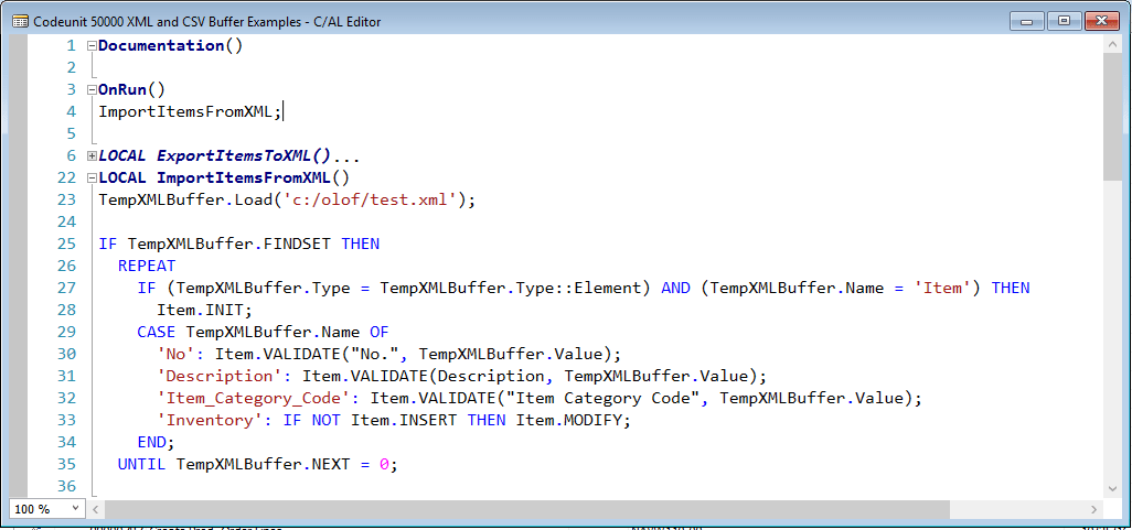

So, how does the import work using the XML Buffer table? It is as easy as the export. You create the table as a temporary variable and just use the function called ‘Load’ to load the XML file into the XML Buffer table. The records in this temporary table can then be processed as any other records. There are some predefined functions in the table to find the child notes, attributes, etc. but when I did this I found it easier just to go through the records in the table, something like below (which might not be the best written code but at least an example).
So that was quite easy as well.

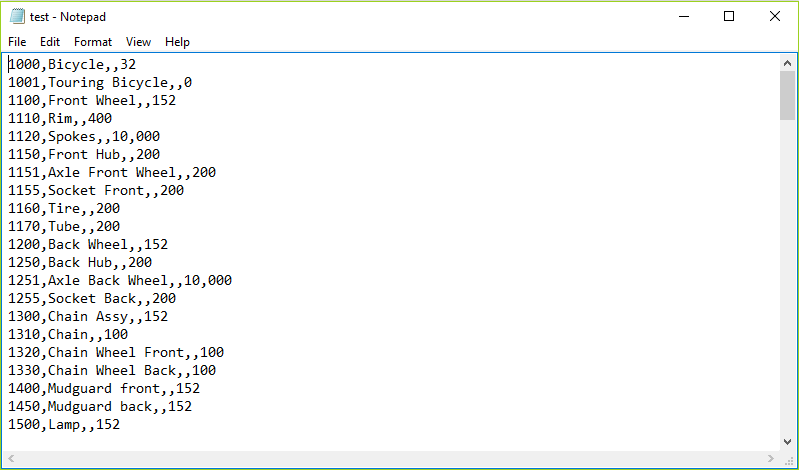

For the CSV export I basically just create a new function that’s very similar to the one for the XML export; but instead of the XML Buffer as a temporary table variable I use the CSV Buffer table (table 1234, cool table number btw  ). The syntax is slightly different, you use the ‘InsertEntry’ function to add data by specifying the line number, field number and value. And then the ‘SaveData’ function to create the file. The ‘SaveData’ function is called with a file name and field separator, in the below example I use a comma as a field separator, I think something like a TAB is much better, but it seems like you will have to modify the CSV buffer table itself to get that.
The file created then looks like below.
Nice!
