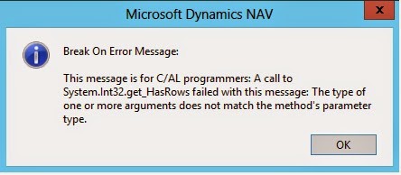

Step 1 was performed succesfully. But After Converting Database to NAV 2013 and Running Upgrade Step 2 i found an error message.
Below is the Screen Shot of the Error Message -
This message is for C/AL programmers: A call to System.Int32.get_HasRows failed with this message: The type of one or more arguments does not match the method's parameter type.

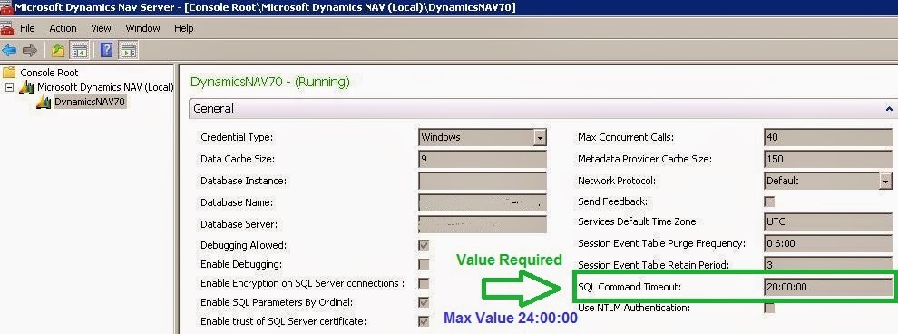

After so much struggle i found out that System is getting timeout during execution of Query.
I know the parameter related to NAV 2013 R2 but was unware that it can be used with NAV 2013.
So Let's see the service tier of the Database that i want to upgrade -
I just changed the value of Parameter "SQL COMMAND TIMEOUT" to 24:00:00, as shown below -
After changing the Value when i run the Upgrade step 2, it worked fine.

During a Upgrade Project from NAV 2009 SP1 to NAV 2013.
