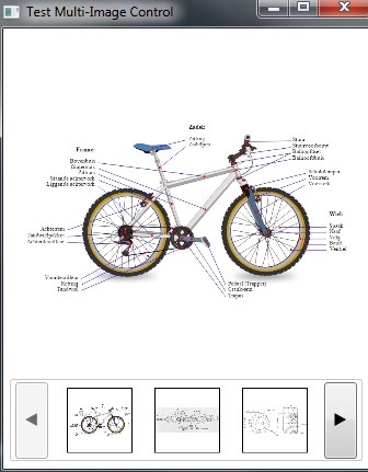

Test Project
Testing
Gerd Altmann
In the sample code, I created a small WPF Application project inside the existing solution. It is a single WPF Window with a reference to the View we created.

That is the entire XAML code for the project! We could have also added the ViewModel here, but to show there are multiple ways to do things, I have done the ViewModel code in the code-behind. One quick note: The MultiImageView was given a name of View so that we could reference it in the code-behind. The actual name doesn’t matter, I could have called it MySuperAwesomeView.

First we create our ViewModel, set the PageSize property to 3 (3 images per page). Next we need to create an ImageSourceConverter to convert our Resource File Pack URIs (strings) to image SourceProperty. We then create an image repository, create a list of images using our trusty converter and then add those images to the image repository. Lastly, we set the View datacontext to our ViewModel.
One final note about setting the datacontext. This overrides the one we set in the design-time datacontext at the beginning of the blog post (I believe the design-time datacontext is actually not compiled into the user control).
Here is a sample of our test project.
Running Test Project
