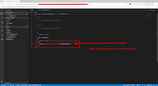

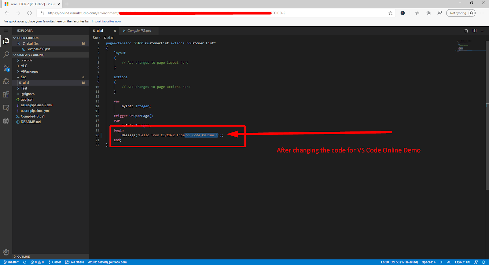

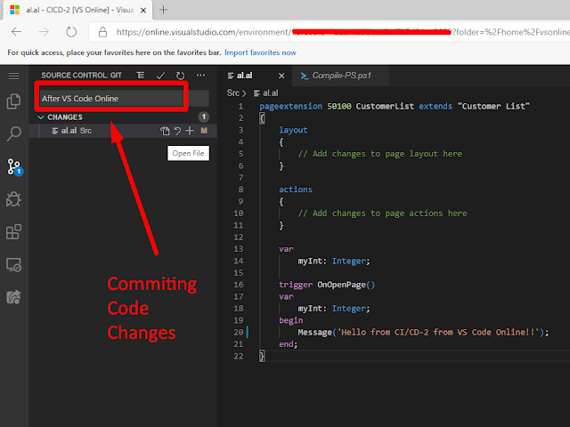

Later as I modified the code  changing the message in VS Code Online
Changing Code in AL Code
After the code has been changed, you can commit and push the newly changed code
Committing the Code

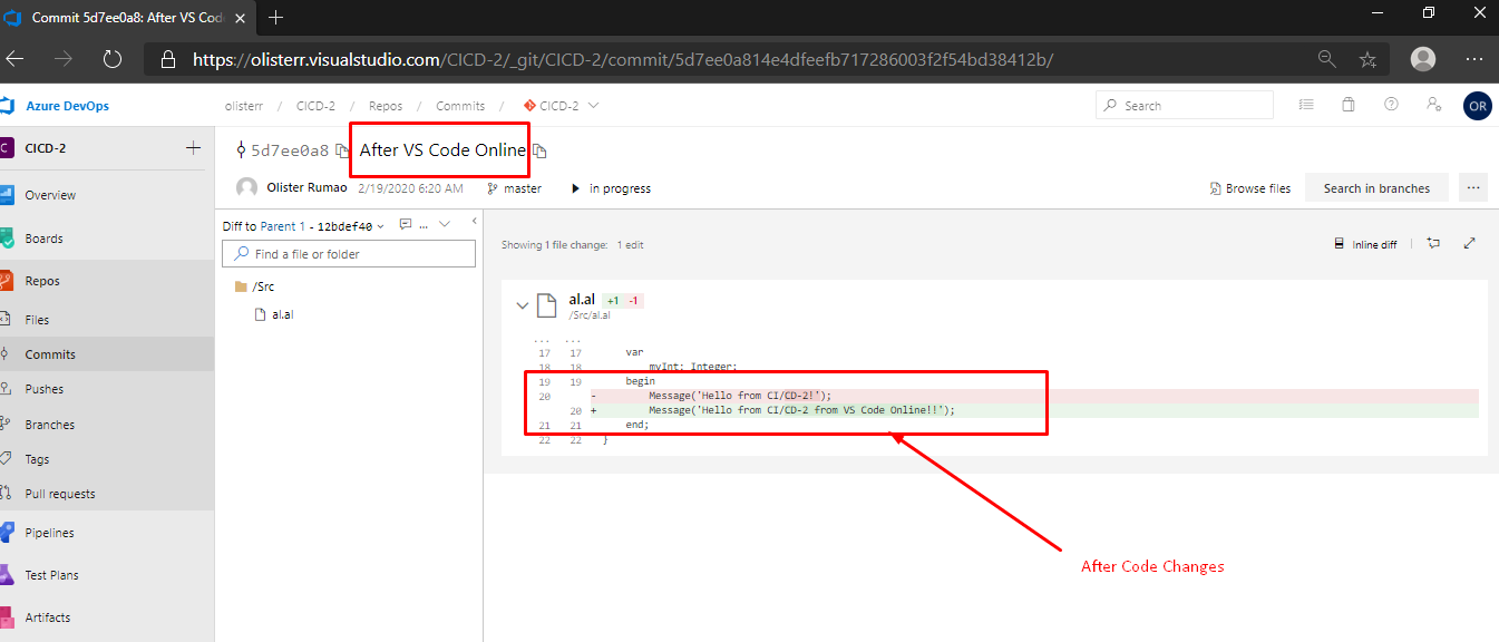

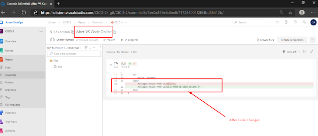

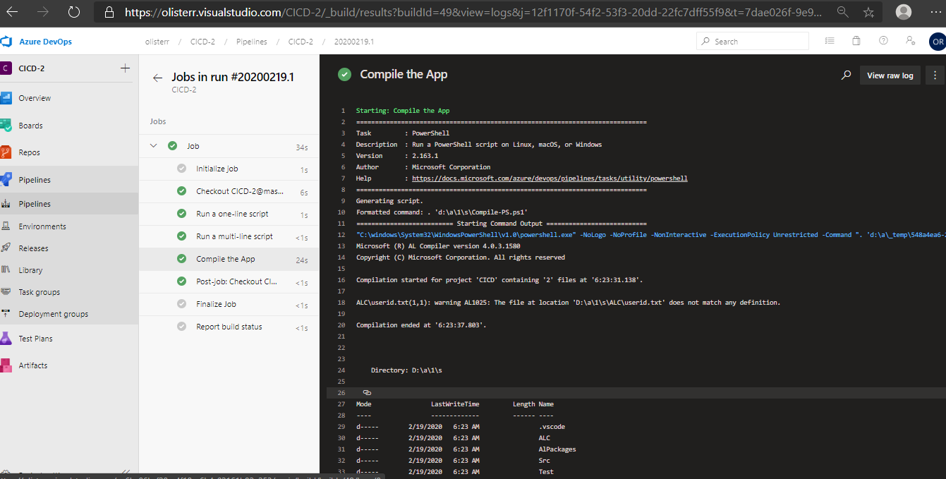

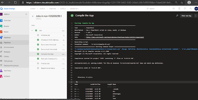

Azure DevOps after committing the code
In Azure DevOps after committing the code, you will find that the Azure Pipelines will start Compiling the App and will deploy it to Business Central.
Azure Pipeline Triggering the PowerShell to compile and deploy the package

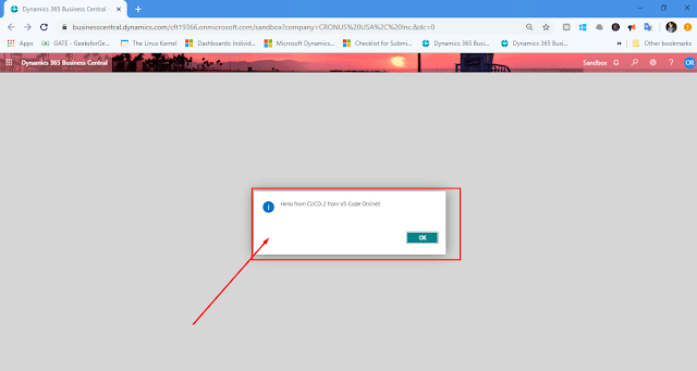

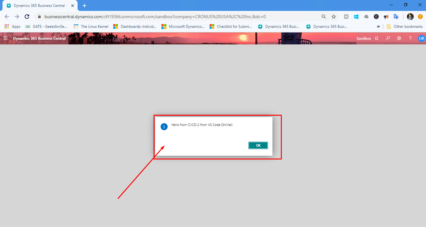

After the app is deployed into Business Central, you will find the message as changed in the AL Code.
After App is deployed in Business Central
