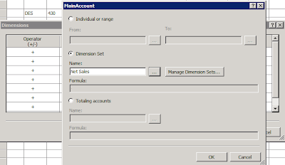

Once you are in the dimension window, double-click in the segment/dimension field you wish to populate and the corresponding segment/dimension window will open (in this case, MainAccount).  Now, you can select the Dimension Set radio button and use the ellipsis (three dots) button to select from a list of available Dimension Sets for the selected segment/dimension.  You can also use the Manage Dimension Sets button as a shortcut to edit and create new Dimension Sets.
Click OK to save the entries you have made, and then you can repeat the process for additional dimensions in the same window, or move on to another row, column, or tree branch on your report.  Now, if you need to add an segment value to Net Sales or to the Domestic Divisions rollup, you can simply edit the Dimension Set and all reports that reference the Dimension Set will be updated!
