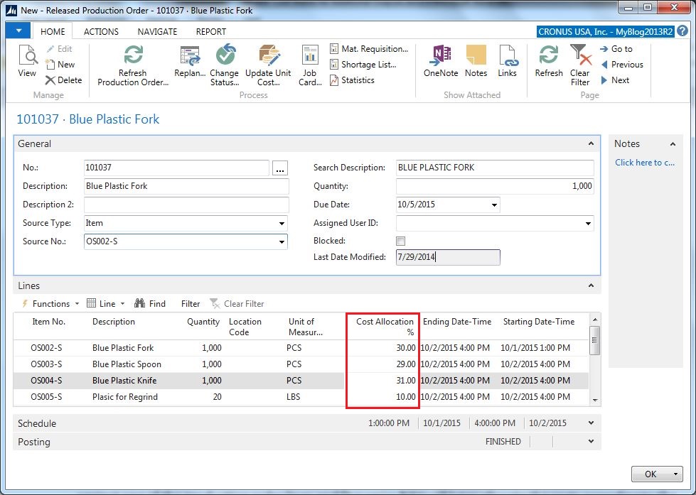

An example of how it can be done; The production order line is extended with a Cost Allocation % field that will control how the cost is going to be allocated (most likely defaulted from the item card or from a setup table of some kind, there are as many variations of this as there are manufacturing companies). The total of the Cost Allocation % on a production order should always be 100 %.
Production-Order-with-Cost-Allocation-Dynamics-NAV

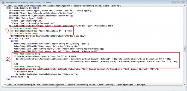

Once the fields are in the database we can go and alter the cost adjustment function to allocate accordingly. This we do in the Calc. Inventory Adjmt. – Order codeunit (5896), where there is a function that handles the material costs (called CalcActualMaterialCosts) and another function that handles the capacity costs including subcontracting (called CalcActualCapacityCosts).
The code can for example be modified according to below. Where #1 eliminates the filter on the production order line (to get the total costs for the entire production order) and #2 adjusts the total costs according to the Cost Allocation % and the totals.
Cost-Allocation-for-Material-Costs-Dynamics-NAV

Let’s test it; we create a production order with multiple outputs, in this case four outputs using FIFO costing method (the same example is also applicable to average cost items). The production order in this case simulates a plastic injection molding process where a plastic fork, spoon and knife are produced at the same time. The process also creates some plastic that goes back into inventory to be re-grinded (e.g. the spure, gate and runner, if you are into plastic injection molding). The allocation of the costs is setup to be 30 % towards the forks, 29 % towards the spoons, 31 % towards the knifes and 10 % towards the regrind plastic.

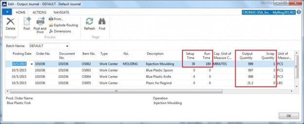

Then we post the output for the different products. In this case we use the output journal where we enter the output quantities, scrap quantities and the times. Note that we now can enter the total time against one of the production order lines and Dynamics NAV will later allocate the costs according to the percentages.
Output-Journal-Multiple-Outputs-with-Cost-Allocation-Dynamics-NAV

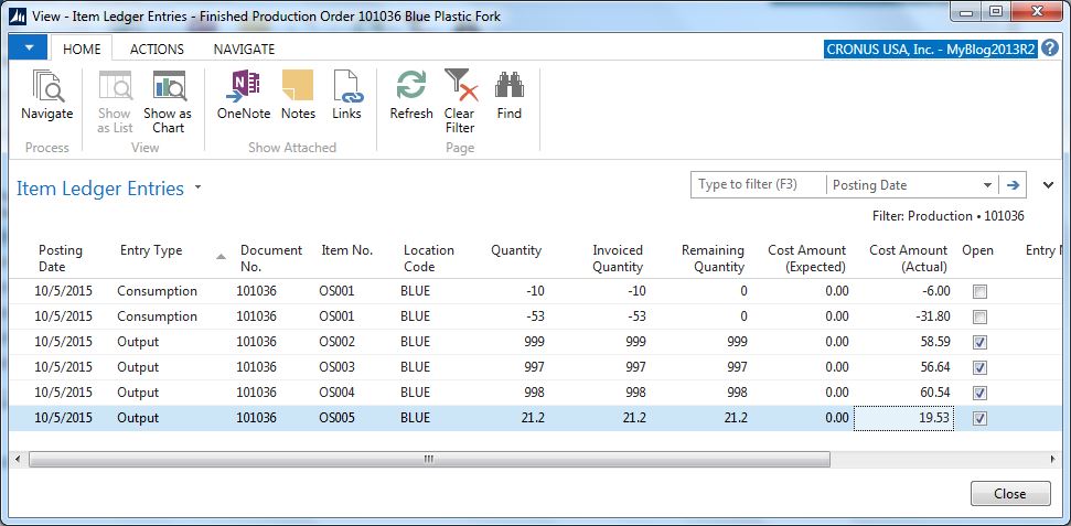

The above creates the following item ledger entries with expected costs for the outputs and actual costs for the consumption (this is all standard Dynamics NAV functionality).
Item-Ledger-Entries-Before-Cost-Adjustment-with-Cost-Allocation-Dynamics-NAV

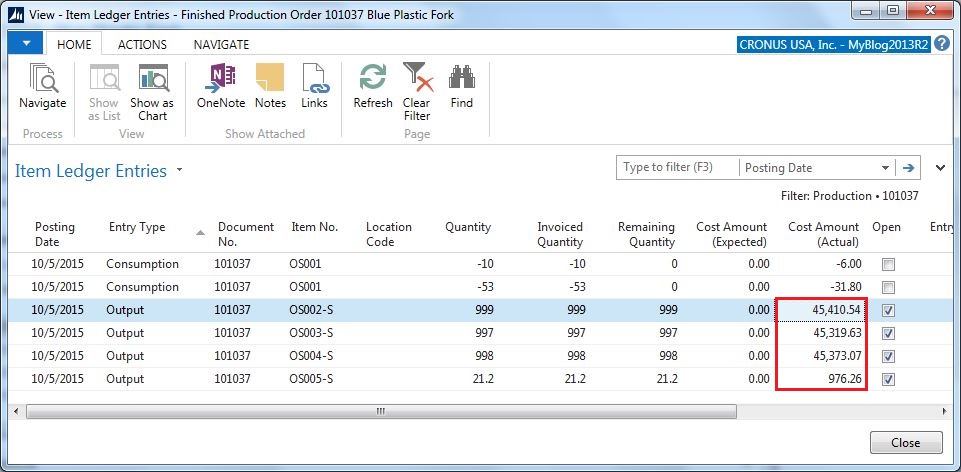

We finish the production order and run the costs adjustment batch job. After doing this we can review the costs of the outputs which now are as below. The total cost of 189 has been allocated by the cost adjustment batch job according to the percentages (30 %, 29 %, 31 % and 10 % of the total 189).
Item-Ledger-Entries-After-Cost-Adjustment-with-Cost-Allocation-Dynamics-NAV
