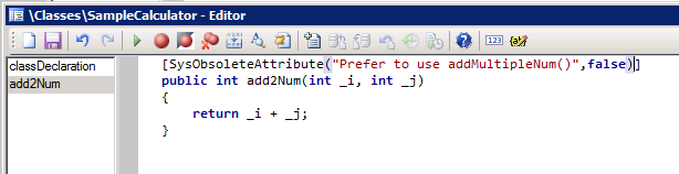

I can decorate my first function add2Num() with SysObsoleteAttribute and to do this I simply have to add the attribute in function definition as shown below:

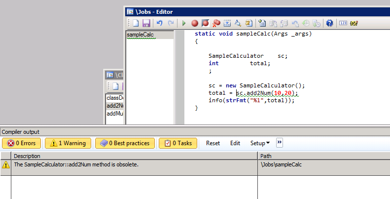

Now the question is how does it impacts the overall process, to know this just compile the job and you will notice that the compiler gives a warning and immediately tells me that this function which I am using in my job is Obsolete.
This is Okay but does it tells me what to do if this function is Obsolete? No not now.
Can I add some more information to the attribute I attached? YES :)
While defining SysObsoleteAttribute you can see that we can define two optional parameters:
So now I added the explanation in the first parameter for the attribute, notice that value in second boolean parameter "_isError" is passed as false for now.

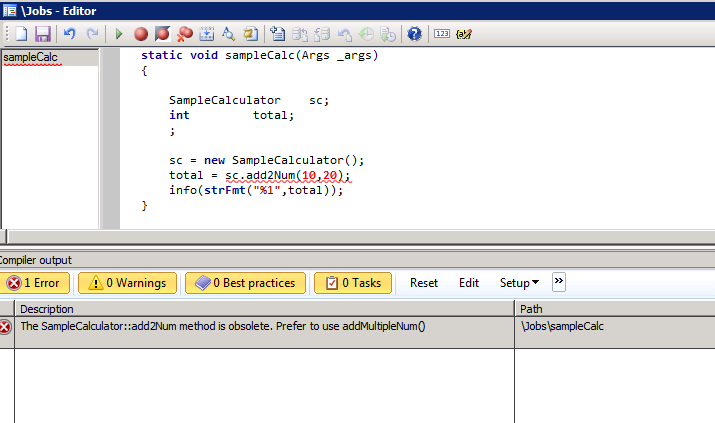

Now let us change second Boolean parameter "_isError" value to true, compile the code and see what happens:
You will notice that compiler gave an error instead of warning. This is quite helpful in situations where we want to avoid use of some function. This is an example of attributes behavior at compile time.
