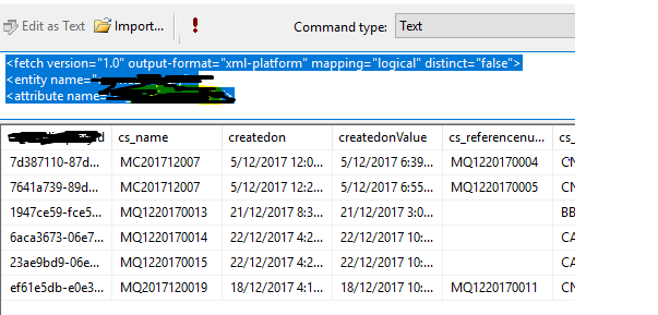

Can able to retrive data in DataSet in Report rdl but not able to Preview

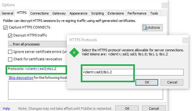

Use fiddler to check the your server request TSL Version. Install fiddler https://www.telerik.com/download/fiddler

2.For Report: Uninstall Report Authoring Extension and install the latest.(Make sure Installed dll has the latest SDK)

4. Modify using TSL to 1.2 through Fiddler
