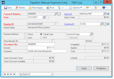

If I manually enter a Payables Manual Payment for a Credit Card Payment Method, it looks like this.
Notice the Amount fields in the lower right corner.  The payment amount is for $111.11, and that amount is displayed in both the Unapplied and Total fields on the left.

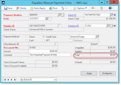

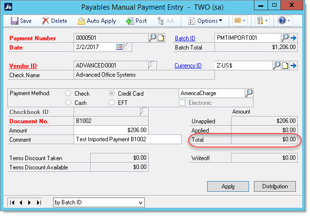

However, this is what an eConnect imported Credit Card payment looks like.
While testing, I noticed that the Total field is zero for the imported Credit Card payment.
