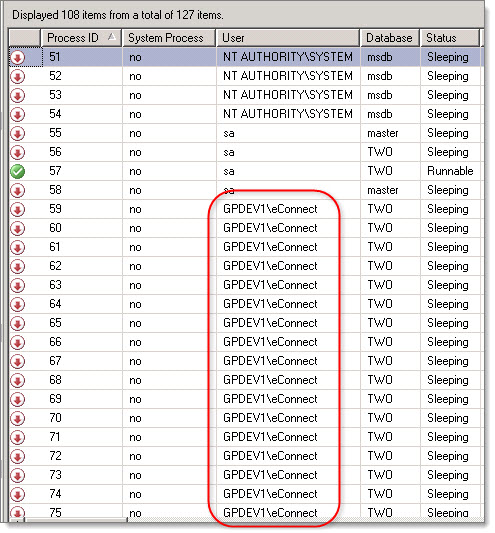

To dig further into the issue, I opened the SQL Server Activity Monitor and checked the SQL processes.  Sure enough, there were over 50 processes listed for the eConnect user.

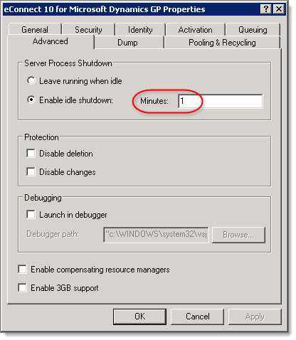

But then I decided to see if there were any settings I could adjust in COM+.   In the eConnect 10 COM+ properties, I reviewed the settings in the Advanced tab and the Pooling & Recycling tab.
I set the idle shutdown to 1 minute, increase the Pool Size from 1 to 2, and to set a Lifetime Limit and Expiration Timeout to try and increase the capacity while recycling the component more frequently.
After making those changes, I am able to generate thousands of journal entry numbers continuously without an error.  But, there is a downside:  increasing the pool size resulted in over 200 idle SQL connections piling up.  Fortunately, once the COM component is idle for 60 seconds, the component shuts down and all of the idle SQL connections are cleared.
