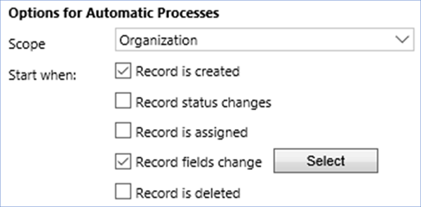

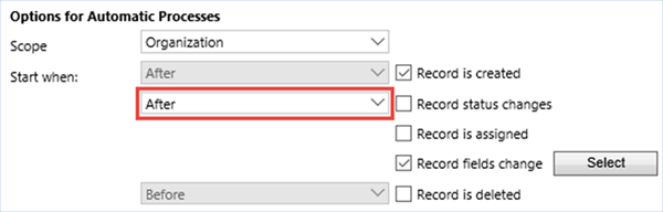

When using a Real-Time Workflow Process, there is an option to configure the Workflow Process to automatically start either after or before a Contact has been updated.

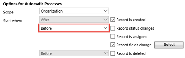

It is important to ensure that the Workflow Process is configured to automatically start After, instead of Before the designated fields on the Contact are changed otherwise the Contact Modified By value used to set the Last Updated By field will contain the previous User who modified the Contact, instead of the current User. This will result in the Last Updated By field being incorrectly set.
Here is what happens when the configuration for automatically starting the Workflow Process is set to Before the Contact is updated; i.e. Before Record Fields Change.

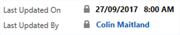

However, if another User now updates one of the designated fields on the Contact the Last Updated By field is incorrectly set to the User who previously modified the Contact rather than to the current User.
e.g. incorrectly to this …

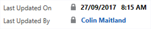

… rather than correctly to this …

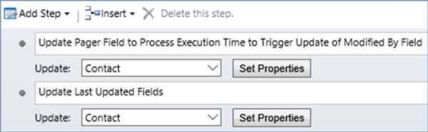

Configure the Workflow Process with two successive Update steps as follows:
  • Configure the first Update step to change an unused field. This change to the unused field will also cause the Modified By field to be updated. Note: You must ensure that this step always makes a change to the field. You can do this by selecting an unused Date/Time or Text field and configure the Update step to set that field to the Process Execution Time; e.g. for a Contact you could set the unused Pager field to the Process Execution Time. This is a text field. Note: If using an unused Date/Time field the Format must be Date and Time rather than Date Only.
  • Configure the second Update step to set the Last Updated On and Last Updated By fields from the Process Execution Time and the Modified By field.

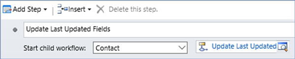

Hint: You could bundle these two Update steps into one single Action or Real-Time Child Workflow Process and then invoke that Action or Child Workflow Process from any other Workflow Process, Dialog Process or Action whenever required using a single Perform Action or Start Child Workflow step.
The following images show:
  • A Perform Action step in a Background Workflow Process that starts an Action named Update Last Updated Fields. Note: Actions always run in Real-Time.
  • A Start Child Workflow step in a Background Workflow Process that starts a Real-Time Child Workflow Process named Update Last Updated Fields.
