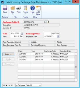

In the example we will work through, we have a Dynamics GP company with functional currency of U.S. Dollars (USD) in which we invoice our overseas customers in Euros. As Euro invoices are generated throughout the month, GP Multicurrency Management translates each invoice to USD based on exchange rates that have been saved to the exchange rate table shown below.
In our example, we generated two Euro invoices on the 10th and 20th of the month that were translated to USD using the rates from the exchange table.

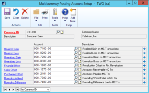

Also, the currency posting accounts must be configured under Financial > Setup > Currency Accounts. For our example, the Unrealized Gain/Loss accounts will be used.

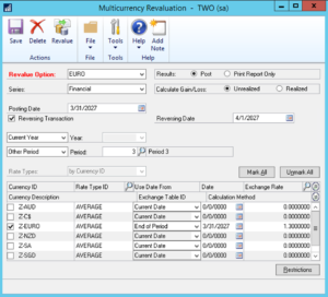

To perform the revaluation, go to Financial > Routines > Revaluation to access the Multicurrency Revaluation window.
  1. Enter a Revalue Option name. You can create multiple options, each with different saved parameters.
  2. Select “Print Report Only” to test the revaluation by printing the revaluation report without posting the results. Select “Post” to print the report and post the resulting entry.
  3. Set the Calculate Gain/Loss option. The default is “Unrealized,” which is the typical setting.
  4. Enter the Posting Date and Reversal Date if you want the gain/loss to be reversed.
  5. Select the year and period to be revalued.
  6. Check the box for each currency to be revalued. You can revalue multiple currencies simultaneously or set up different options for each currency. Select “End of Period” to default the end-of-month rate from the exchange table.
  7. Use the “Restrictions” button to set ranges of posting accounts or account segments to be revalued.

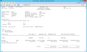

  8. Click “Revalue” to process the revaluation. The Revaluation Journal report displays each revalued account with its originating balance, blended rate and functional amount. The Unrealized Gain and Loss columns reflect the calculated revaluation amount.
In our example, the originating balance of €30,000 is revalued at the month-end rate of 1.3, which totals $39,000 USD. The functional balance of the account is currently $35,000 USD, which results in an unrealized gain of $4,000 USD ($39,000 – $35,000 = $4,000). Note that the calculated gain or loss amounts are always recorded in the functional currency.

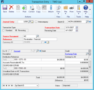

If you selected to post the results, the revaluation process creates a General Ledger journal entry to record the exchange gain or loss. In our example, the $4,000 USD gain is recorded to the Unrealized Gain account 000-7200-00 from the Multicurrency Posting Account Setup. The offset is recorded to the original account 000-1270-00 as shown below.
