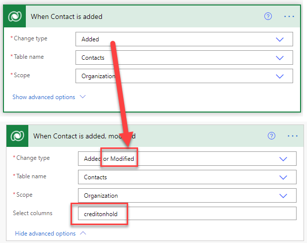

First of all, update the trigger by setting the Change type from "Added" to "Added or Modified" so that the flow will be triggered OnUpdate as well.
But we cannot let the flow run on every update of the Contact. Otherwise, the flow will be triggered unnecessarily if someone updates the Contact during this data patching exercise. To avoid that situation, set one of the unused columns in the Select columns parameter so that nobody would update that column value and the flow will not be triggered unintentionally. In my example, I used "creditonhold" column but you can choose any unused column for your table.

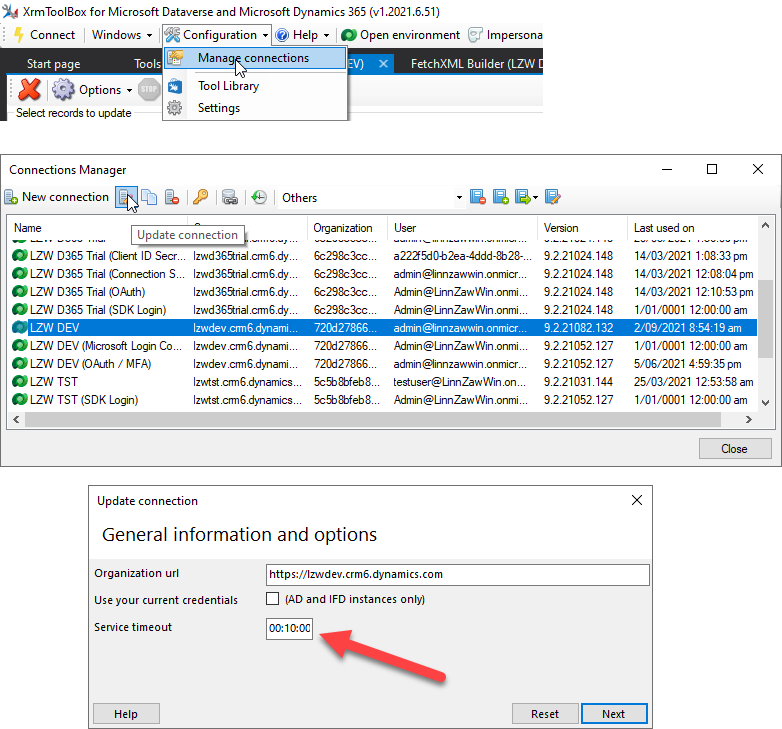

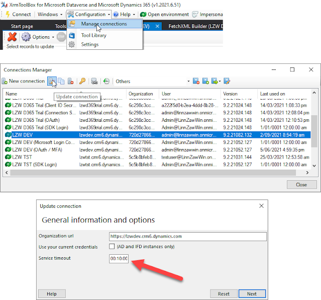

to make sure that the number of requests does not exceed 6000 within the 5-minute sliding window. If the Wait between calls setting is longer than 120 seconds, the tool may stop working with the timeout error. In that case, update the Service timeout setting of the connection to the environment.

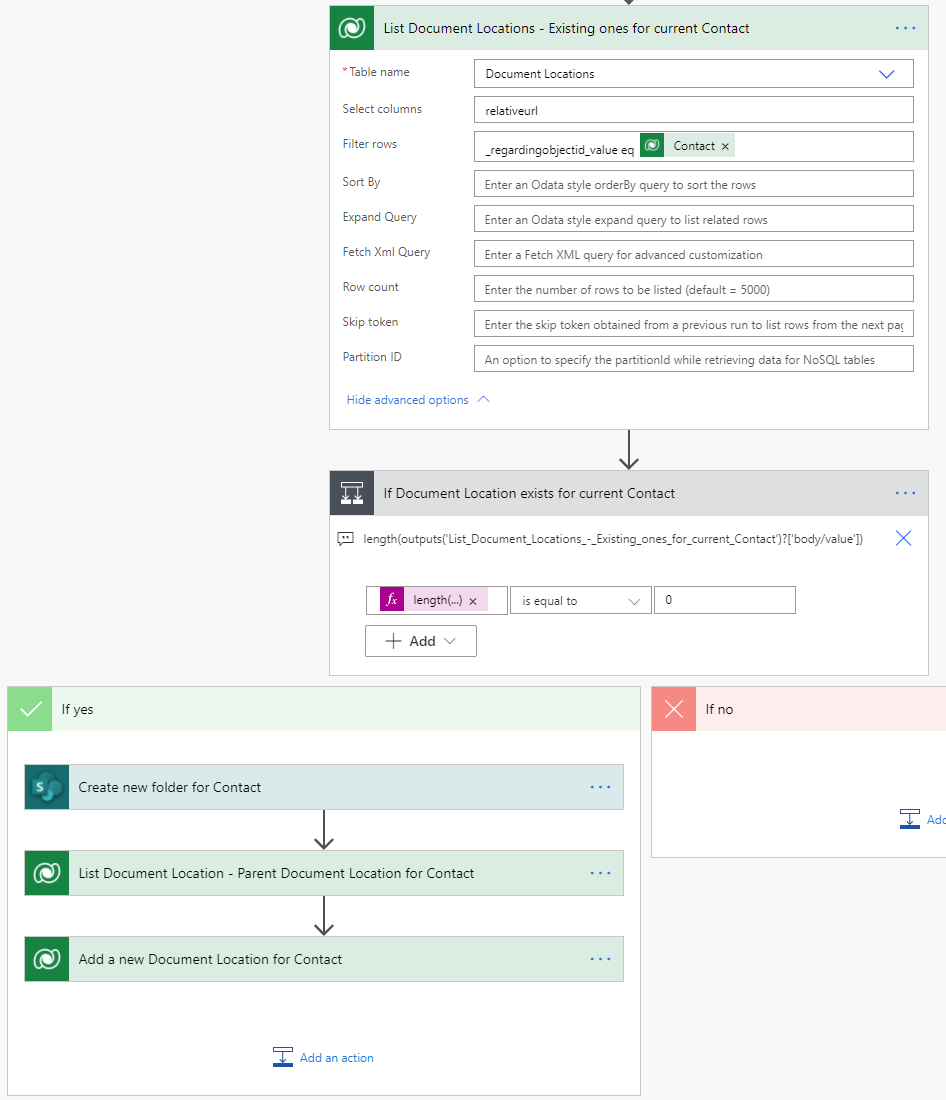

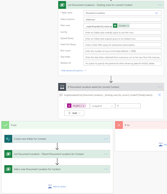

To avoid accidental creation of the Contacts which already has the SharePoint Document Location, you can update the cloud flow from my previous post and add the steps to List the existing Document Location for the Contact and only create when there is no existing Document Location.
