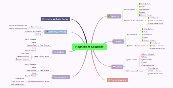

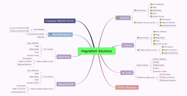

An example of a simple XMind mind map is shown below to show a layout of a test strategy in Microsoft Dynamics CRM (for demonstration purposes only).  We can group similar components together, then branch out any relatable aspects and conditions to test in XMind. It also equips the planner with various other visual elements such as colour, styles and symbols to help visualise anything in the map.
We can use colour to group and distinguish Entities (light purple) from other components to test in Dynamics CRM.
While it may sacrifice other details, it allows the tester to outline and visual the test plan overall while looking at the most important aspects of the project grouped together. While the trade-off is that it is can be an informal documentation process, it is a process planning tool that can be made quickly. It also allows the tester to dump information quickly and visualise information. As a visual aid, it helps with the thinking process and visually project representations in order to ease the mental load. From here, we can further strategize our approach in conducting our testing.

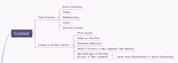

We can also map out test cases to execute in order to test conditions, process and business logic. Mapping out conditional branches can be done easily so that we can know what conditions to test out.
Again, for example, if we are testing our plug-ins in Microsoft Dynamics CRM given the business logic:
IF Field Age >= 65 AND Field Country = “New Zealand”, THEN Field Classification = “Senior Citizenship”
We can portray this in XMind under the Contact entity. We test for this condition by creating a record, and making the appropriate changes needed to test this business logic as shown below in XMind.
We can map out test conditions when setting changes and verifying business logic.
