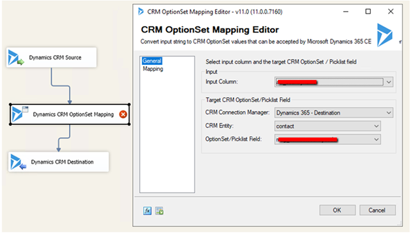

Step 1: Setup OptionSet Mapping component between your source and the destination flow tasks.
Step 2: Fill the below options:
•    Input Column: Select the field to receive the data from.
•    CRM Connection Manager: Choose the target Dynamics system.
•    CRM Entity: Choose the desired entity in the destination system.
•    Option Set/Picklist Field: Specify the optionset for mapping.

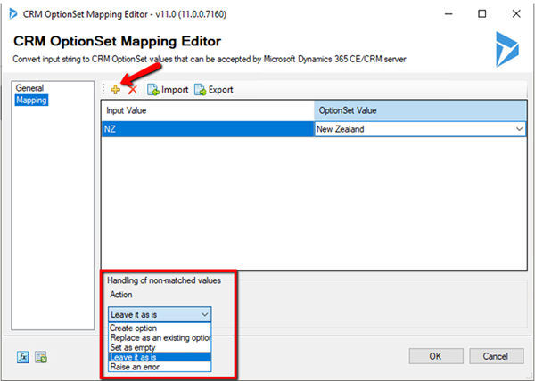

Step 3: Add your mapping by clicking on the add (+) icon and, define the Input and the OptionSet value.
This wizard also lets you import and export the optionset mappings. You can also further handle non-matched values from the Action dropdown menu having choices as below:
Create option: This creates a new option of the chosen input value for the specified optionset field if no match is found.
Replace as an existing option: You can specify another option value to be used if no match is found.
Set as empty: As the name describes, it sets the output value of the column to empty if no match is found.
Leave it as is: This is the default value which passes the chosen input value.
Raise an error: This option throws an exception and stops the complete process if no match is found.
