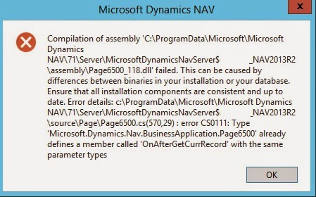

After upgrade from NAV 2009 / NAV 2009 SP1 & NAV 2009 R2 you might have faced an error message as shown below -
ERROR -
Compilation of assembly 'c:\ProgramData\Microsoft\Microsoft Dynamics\NAV\71\Serve\MicorosoftDynamicsNAVServer$..\assembly\Page.dll' failed.
This can be caused by differences between Binaries in your installation or your database. Ensure that all installation components are consistent and up to date.
Error................................
We try to compile objects and its doesn't throws an error message but during run time the system popups up the above error message. Even the Debugger Doesn't help.
When i tried everything i thought of reading the complete error message and yes that was need to be done. The cause of error was specified in the error message.
Let's see what was it in my case.
Finding After Reading the Error Message -
1. I received this error for Page 6500.
2. Reason - I have two Functions with same name i.e OnAfterGetCurrRecord. (as shown below)
Resolution -
So i just designed the page and removed customized Function OnAfterGetCurrRecord, and the error was removed.

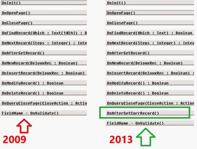

If you remember in NAV 2009 Versions we don't have the standard OnAfterGetCurrRecord Function in Pages, but with NAV 2013 and onward we get this function back. So i 2009 Due to some requirement we had created the function as customized.
Below are the Page triggers in NAV 2009 and NAV 2013.
