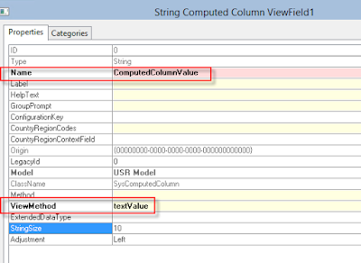

Now we add a new string computed column field in the view and link it to this method
To do this, Right click on the fields >> New >> String computed column
In the properties for this new field >> View method >> Select the method we created above

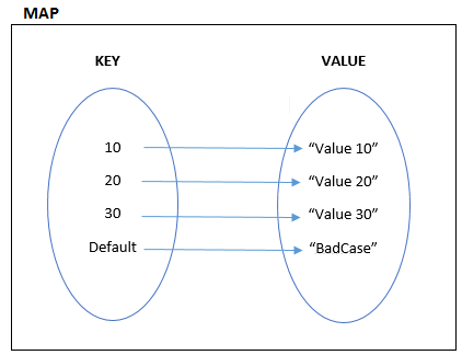

SWITCH: Below is the syntax of the function. It accepts a Case expression , Map (for storing the values) and the default expression
Lets modify our method to Switch on the basis of CustGroup and populate a map based on the case condition.
Below is the code template:

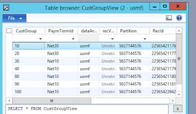

So lets play with CustGroup table and create a simple view out of it:
- Right click on AOT >> DataDictionary >> Views and create a new view
- Add datasource "CustGroup"
- Add 2 fields, CustGroup and PaymTermId
Browse the view just to make sure the values coming in the table browser.

Create a new method in the view as shown below:
