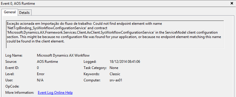

Verificando o Event Viewer do servidor de AOS localizei a seguinte entrada:
"Exceção acionada em Importação do fluxo de trabalho: Could not find endpoint element with name 'NetTcpBinding_SysWorkflowConfigurationService' and contract 'Microsoft.Dynamics.AX.Framework.Services.Client.AxClient.SysWorkflowConfigurationService' in the ServiceModel client configuration section. This might be because no configuration file was found for your application, or because no endpoint element matching this name could be found in the client element."
