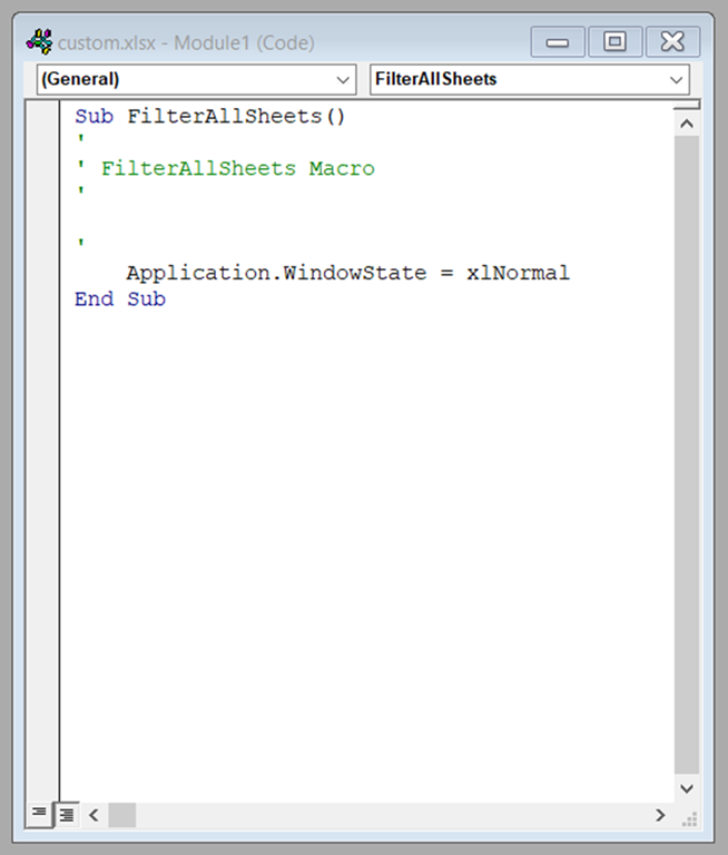

Using Macros and Visual Basic to Filter All Sheets
Using “Select All” we have the option to delete different rows and columns from all sheets, but we cannot filter all sheets without the help of Macros and Visual Basic code. Go back to first sheet of the document, click on “View”, then select “Macros” and then “Record Macros”. (Steps highlighted in Blue). Enter the Macro name, and then click on OK.
Once the Macro starts recording, select “Stop Recording”, this can be done from the same option list where you selected “Record Macro”. In that same option list, you will select “View Macro”, then select “FilterAllSheets” Macro and click on “Edit”. A window will open with some Visual Basic code.
For each sheet, I wanted the table to be filtered based on “Required Level”. After filtering only those rows should be displayed where Requirement level is either  “Application Required” or “System Required”. Based on the requirements I replaced the code as shown in the screenshot below and clicked on “Run” icon.
As seen in the screenshot below, I selected a different sheet and the table is filtered as desired. Also by looking at the row numbers, we can tell that none of the data was deleted from the table, only filtered. The filter can be removed at any time.
