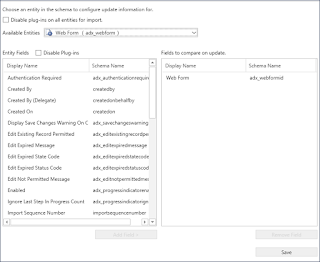

3.  Create schema with Configuration Migration tool.
-   add all adx entities ("adx_*") to the schema
-   set adx entity's id ("adx_* id")  as criteria as shown in the screen shot
The schema can contain all adx entities and criteria must be defined per entity according to the portal type and environment requirements. Have a look on the example links of Basic Portal schema and list of adx entities those are attached to the post.
