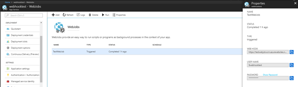

First, we want to get the WebJobs Web hook URL and the credentials from the Properties of the WebJob in the Azure portal.
Once we have the credentials, we then need to create our authentication header value. To authenticate with the Azure WebJob we are going to use Basic Authentication. For this we first need to have our credentials separated by a colon and then Base64 encode the result. I use the online encoder at https://codebeautify.org/base64-encode to do this.

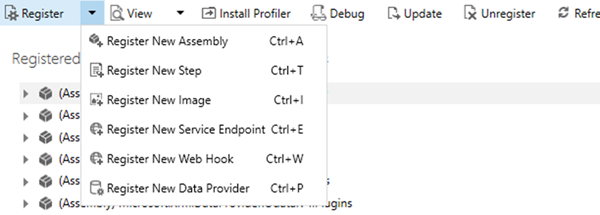

Then to register the CRM Web Hook we go to Register => Register New Web Hook in the Plugin Registration tool.

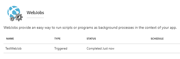

Now after creating a contact, we can refresh the Web Jobs page and see that it has successfully triggered the Web Job.
