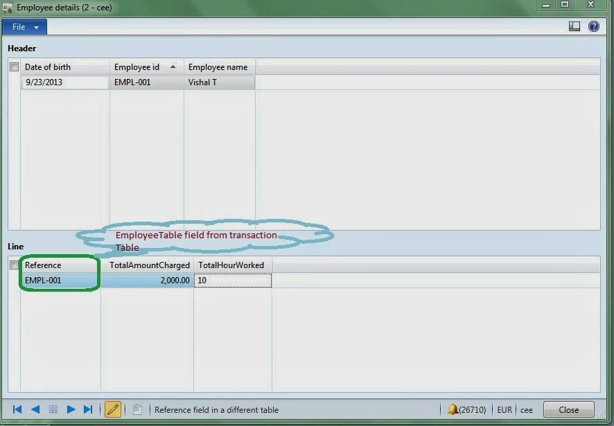

Since form is the artifact which is user oriented (Client interface). Now let’s create a form and check how it appears there. So am just creating a simple form which consist of these two table as datasource and using the joinsource property to join them. Form structure looks something like this:
So basically, header and line part in form represents “employeetable”&” employeetransaction”. Here in header part details can be filled up & emplid can be easily accessed and if you look at the line level there is a field called reference which I dragged from transaction datasource > emloyeetable field.  For reference, just look at the form image above.
Now here comes the magic J as soon as you create & save the record in header then line level reference gets filled up with related emplid field. But if you look at the backend in tables it would be stored as recid.
So I can say that Alternate key allows the system to display significant value on forms instead of a meaningless numeric primary key value. Each table can have a maximum of one replacement key.
