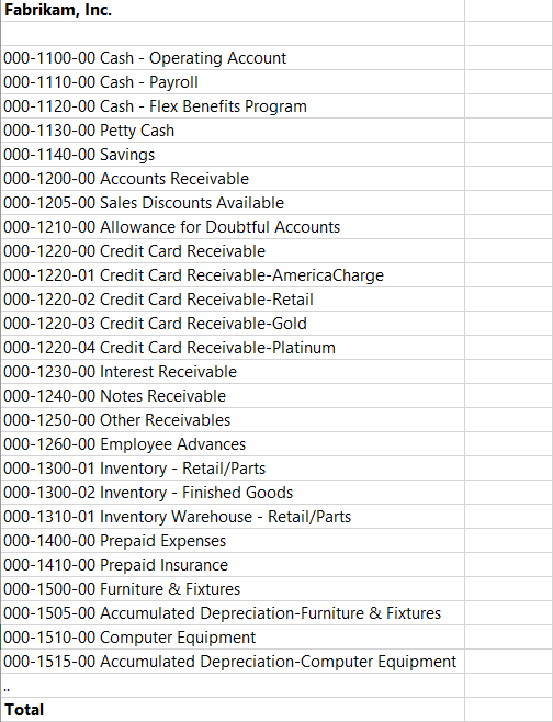

One of our customers requested to have their report definition of "Management Reporter" gets updated automatically whenever a change on the chart of accounts occurs. This can be simply automated by considering the "All Accounts" function of MR which by default retrieves all accounts to the row definition regardless of any criteria. A link will show up on the home page, on which you click and drill down for details of "account numbers".
Although, the case is different as we have to consider a specific representation of he GL account, each account should have the "Account number" first along with the "Account Description".
The structure includes Dynamics GP and Management Reporter data mart, which runs an integration between Dynamics GP database and MR DataMart, so that data can be structure in an easy and efficient way for reporting purposes.

Management reporter has two main components for every report, row definition and column definition. In our case the row definition includes the list of accounts in a "Static" manner, along with a "Total" row at the bottom. Here is a screen shot of how the "Row Definition" should look like as derived from Fabrikam GP Test Company
MR Row Definition
