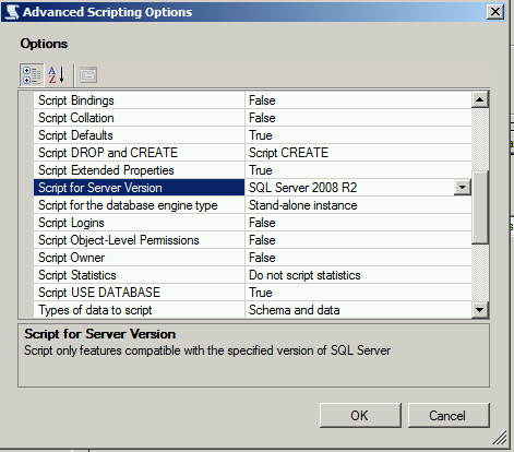

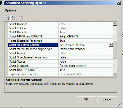

Then in the source SQL 2012 environment I right clicked on the database - clicked "Tasks" - and clicked "Generate Scripts".
The settings for the scripts are below:
1. choose to script the entire database and all objects

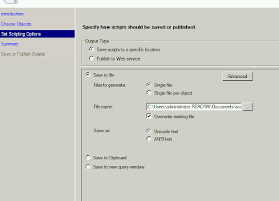

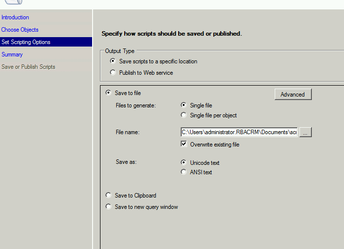

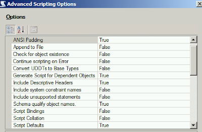

2. Here are the base options, click the "Advanced"  button to set the advanced options you will need.
3. Match the options from the next three screen shots
4. Now generate your script file.
