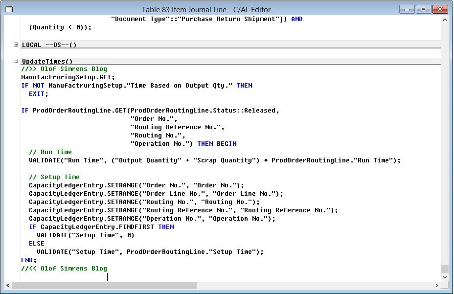

Create a new function in table 83 – Item Journal Line, call it something like UpdateTimes. The function will be called when the output or scrap quantity is entered in the output journal and it should then calculate the setup and run time for the journal line based on the expected values in the production order routing. The below code is kind of self-explained; it grabs the production order routing line record and calculates the run time by multiplying the run time from the routing by the output plus the scrap quantity. The setup time is entered if there are no other transaction on the operation, if there is then it is zero (the concept with a setup time is that is supposed to be only once per production order). There is also a way to turn the calculation on/off through a new field in the manufacturing setup table, I always do modifications so they can exists together with how the standard functionality works (if you for example have additional companies in the same database that don’t want to use it this way).
Code-To-Calculate-Setup-and-Run-Time-In-Output-Journal-Dynamics-NAV
