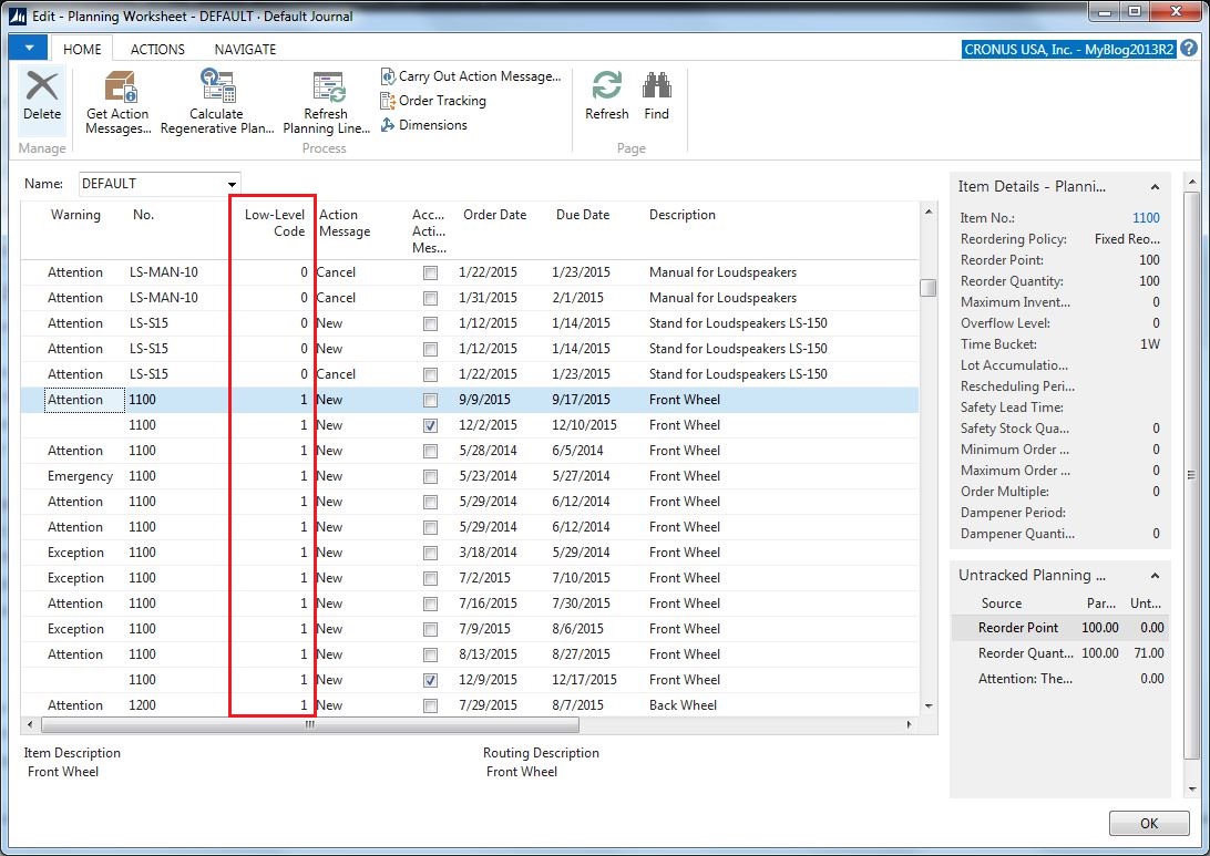

Planning Worksheet
The one place where you can see and use the low-level code as a user is in the planning worksheet. This can be used by the planner to know what items that potentially can be affected by a change to a suggestion. If you for example increase a quantity for an item with a low-level code as 2, then you know that items with low-level codes being 0 and 1 will not be effected but lower level items might be since the demand for those just increased.
