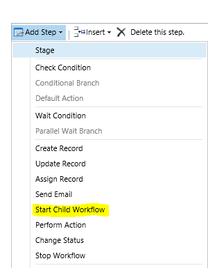

How to Call a Child Workflow From Another Workflow
A child workflow can be added to another workflow like any other step. Click ‘Add Step’, then ‘Start Child Workflow.
This adds an editable step to your workflow which allows you to select the entity that you want the Child Workflow to run on - this may be a related record, or the record that the primary workflow is running on – and of course, specify the workflow that you want to run on this record.
This step acts like any other step in that it can be placed inside conditions, and other steps can be performed before or after it.
Take care when adding child workflows though, as no error message or prompt is presented if you try and add an inactive workflow. Activating the parent also does not active the child workflow. If you are intending on using the parent workflow, make sure that you activate the child workflow, or the logic will hang as described above.
