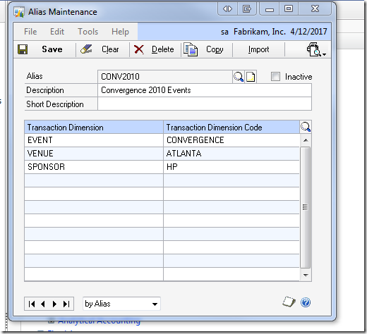

Open the window from Cards >> Financial >> Analytical Accounting >> Alias
Set the defaults.

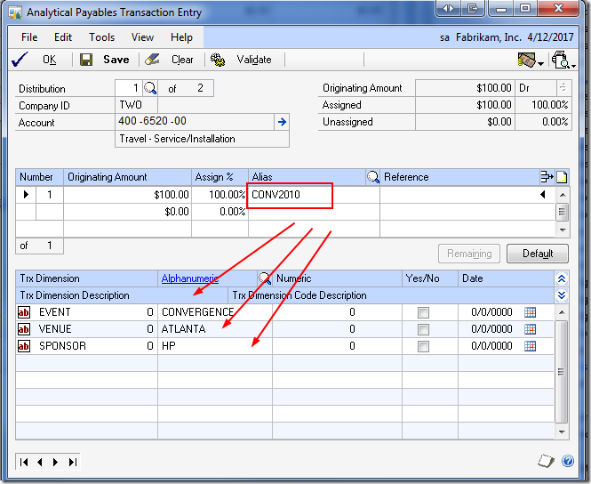

The Magical World with AA Alias!
When you open the AA Window, the cursor is already placed on the Alias field. All you have to do is enter the Alias, and it would fill all the dimension codes for you. Excuse my dramatization, but I am sure anybody who has spent more than an hour entering transactions with AA codes would share my enthusiasm!
