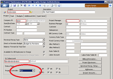

When setting up the project for budgeting purposes remember to set the Project Controller status flag to Plan. This allows the project to be visible in the system but no charges are allowed against it. This is a key worry in the accounting department when it comes to what is available for project managers to charge against. Accidents happen!
project controller

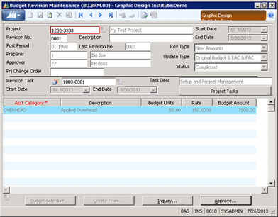

BRM is the tool that handles managing our initial and revised budget, but for this little test, we’ll only look at an initial budget.
Since our test project is just a one task, one account project, we’ll estimate we need about 50 man-hours of work at an expected rate of $150.00 and assign it all to overhead. Most of the fields are self-explanatory, but for an initial budget, we want to make sure that Rev Type is set to New Amounts and Update Type is set to Original Budget & EAC & FAC. Status is left to In Process until we are done with the budget preparation.
budget revision maintenance
Since our budgeting is done via Account Categories, a well thought out Account Category to Chart of Accounts mapping is recommended.
Once the preparer has changed the Status to Completed and clicked Save, our new budget becomes greyed out in this screen.

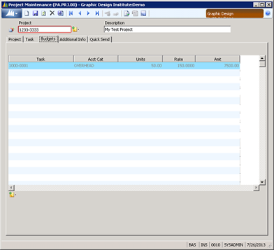

Now back in Project Maintenance on the Budgets tab, we can see that our budget has been entered…
project maintenance
