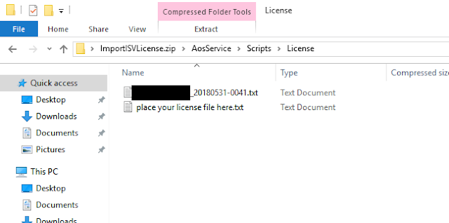

Make a copy of this zip file and open it up. Then browse to the following location: ImportISVLicense.zip\AosService\Scripts\License
Copy the license .txt file into this folder and save the zip.
NOTE: During my first try of this I extracted the zip, copied the file into it and zipped it back up. However during the next steps below that allow the license file to be applied I received an error message saying it has an invalid HotfixInstallationInfo.xml even though I did not touch this file. If you modify the zip directly LCS has no issues with the file so I would recommend not extracting the zip file but rather just using the default one as a template and copy the zip somewhere else and make the change there.

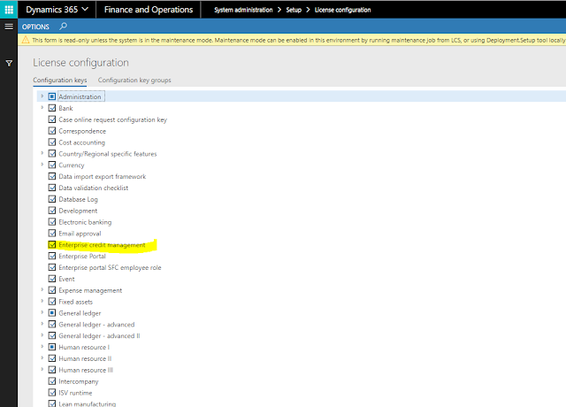

You should now be able to log back onto the environment and see that the isv solution is now there
And that the license configuration page now has the license checked.
