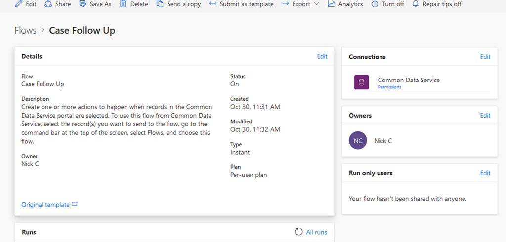

To export your Flow as a Package, select the Flow and click “Export”
Then select “Package (.zip)”

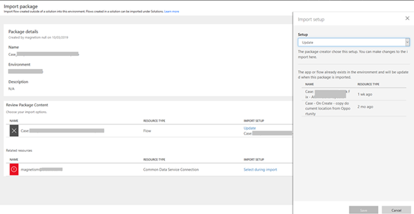

In the Package details you can configure the Flow’s “IMPORT SETUP”.
You can choose whether the Flow is being created as new or updating an existing Flow. This will default to “Update”. If the Power Automate Flow doesn’t exist in the Dynamics 365 instance you’re importing to, then you can select “Create as new” before exporting. Note that if the Import Setup is “Update” you can still change it to “Create as new” on Import, however it will take a few extra steps.

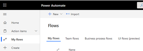

Upon Importing the package, select the Import under My flows
If this is an Update Package it will display the existing Flow(s), select the Flow you want to update and click Save.
Notice the difference coloured icons? Grey is for a selection to be made, red invalid config and green is valid config.
Once the package has been uploaded it will display the Package details. In the Package Content the “Create as new” will have a green tick. This is because the Import Setup is “Create” and no mapping to an existing Flow is required.
For the Common Data Service (CDS) Connection, if there is an existing CDS Connection select that, otherwise create a new CDS Connection.
