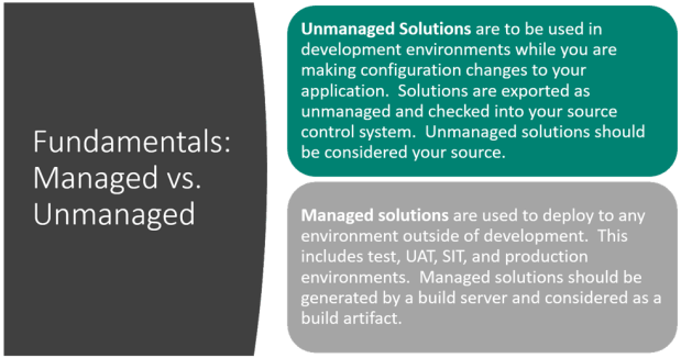

 Solutions come in several different flavours, the primary being managed or unmanaged.
Managed vs Unmanaged Solutions
The introduction of solutions in Version 5.0 sparked significant discussion within the community in terms of whether to use managed or unmanaged solutions. Several characteristics of managed solutions had not been fully established, which often led to misappropriates use of unmanaged solutions.
Managed solutions were often perceived to cause problems. Unintended dependency issues sometimes made them challenging to remove, and the order of import could influence the application behaviour presented to the user if not reliably managed. In the current Dynamics landscape, managed solutions have matured and are the recommended approach for any downstream systems.
There are essential differences between unmanaged and managed solutions which requires a good understanding of how layers are created and intermingle with one another. The variations between the two types of solutions are summarised in the table below:

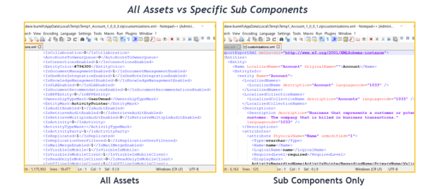

Should I add all Assets?
With the segmentation functionality, you can add all assets for a component or individually select only the required assets.
When selected all elements and attributes are added to the solution. This means that for example, you are only adding a single field to the entity that the whole entity with all its attributes will import into your next environment creating layering.
As you can see, when selected, all the attributes of the entity are added to the solution.
If however, you leave it unticked you can add individual components that you wish to change or modify there for reducing the effects of layering and dependencies.
By adding only the sub-components to the solution, the only layering that will happen by importing this solution will be on the account name attribute rather than the full account entity.
When you compare the difference between both options, you can see that the size and complexity of the solution are far reduced by only adding the components that you require.
