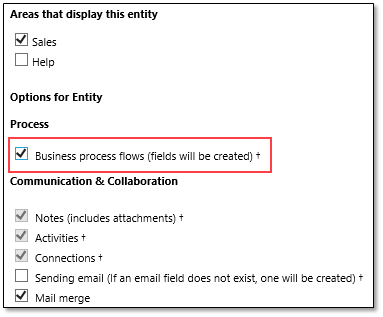

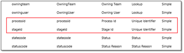

When you first tick the 'Business Process Flows' checkbox in an entity's details and save the changes, two new fields are added to the entity – processid, and stageid – which record the business process flow and stage of the flow being used by records of that type, respectively.
It's perfectly possible to change the values of these fields programmatically in order to change the business process flow or stage being used by a record, however it may result in certain unexpected graphical errors. I'll cover the unexpected behaviour and a possible workaround at the end of the blog. For now, here's the plugin code I used to set the business process flow active stage of a record based on its status reason.

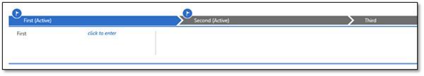

The unexpected behaviour I mentioned earlier occurs when your plugin changes the active stage of a business process flow upon saving the record. You may find that the active stage will correctly change, but you won't see it happen immediately – instead, a new flag is made visible on the stage which has been activated, but the old stage will still appear to be active also, as you can see below.
