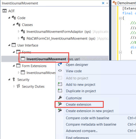

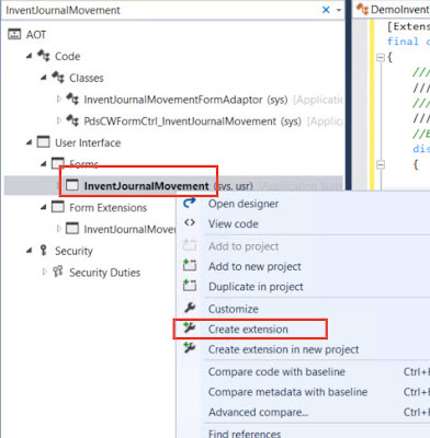

4. Now find the 'InventJournalMovement' form in AOT and create an Extension

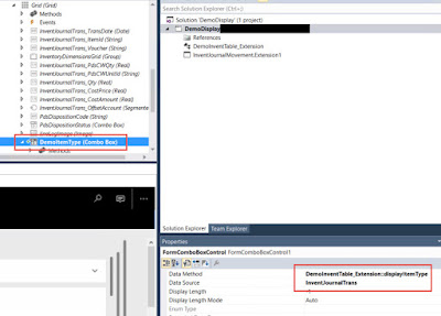

5. Then open the form and create a column as per your requirement.
6 . After create a new column, right on the column and select properties and then select the data source and data method which we have created in a final class.
7 . Build the solution. Now we should be able to see that column in Movement journal lines form
