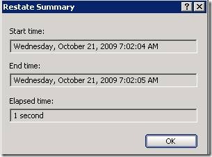

To Run a Restate
  1. Select Data | Restate from the Program Menu. The Restate dialog box will appear.
  2. Click OK to start the Restate. When Restate is complete, a Restate Summary will appear, displaying the total elapsed time for the Restate.
clip_image001
