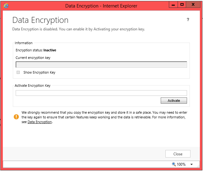

If we try opening that Data Encryption window again, we should see that encryption is disabled, and we can create a new key and activate it.
Data Encryption Errors After Restoring Microsoft Dynamics CRM Database
You should be able to get the encryption key from the original CRM system you backed up from. If not, then you can simply create a new encryption key.

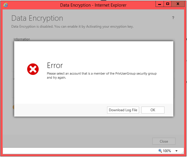

When you activate, you might be faced with another error which states “Please select an account that is a member of the PrivUserGroup security group and try again”
A simple solution to this issue would be to use an account with which the CRM instance is installed or add this user to the security group mentioned in the error.
