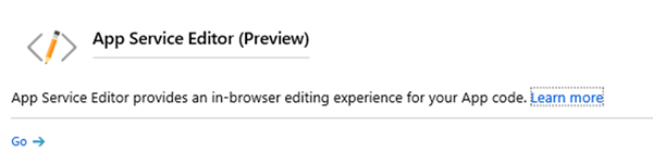

Requirements change and we all must update our logic at some point. When updating a WebJob this can be done in a few ways, such as using an FTP or alternatively you can use the App Service Editor. This editor can be found under the development tools section of your App Service. You will be presented a screen like this:
Click Go to go to the App Service Editor. Then go to Jobs > Continuous/Triggered > Right click and select Upload Files.
