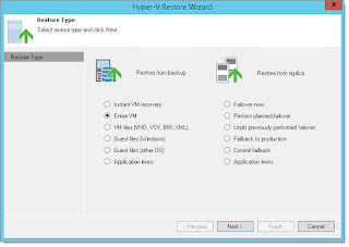

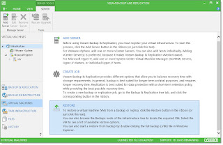

I clicked on Restore
Chose to restore the entire VM.  Note the other options--I could have potentially restored individual files from the VM.

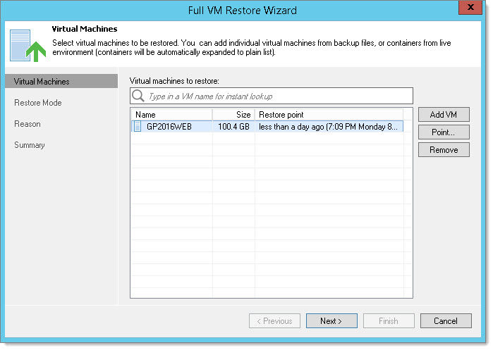

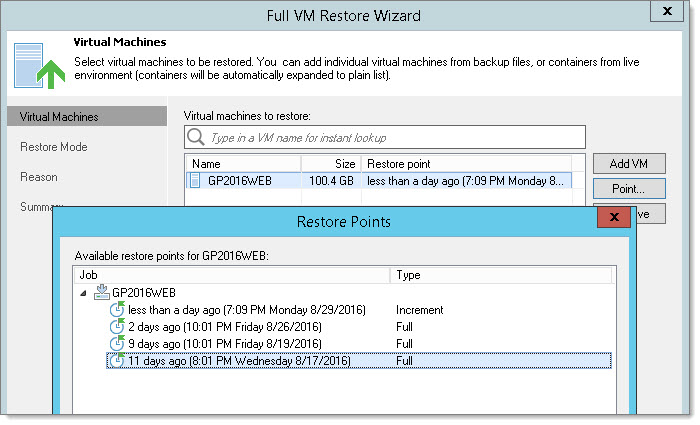

I chose the VM I wanted to restore from backup.

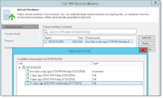

I then clicked on the Point button and chose to restore the first backup of that VM, from August 17th.

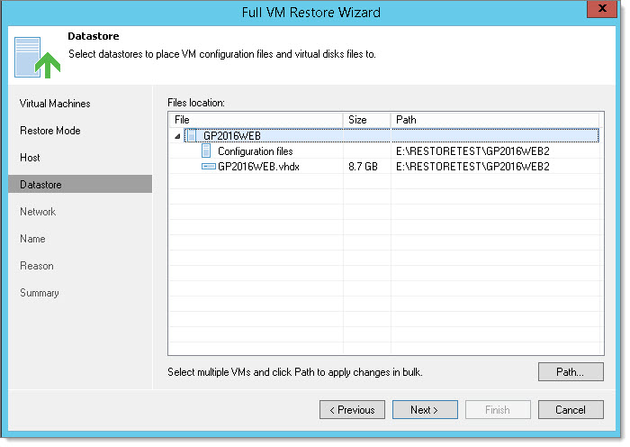

I then chose to restore to a new location, as I wanted to create a new test VM, and not touch my live VM.

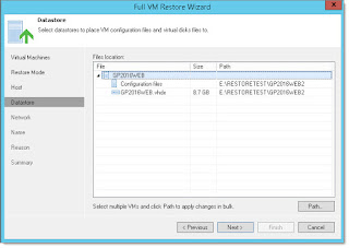

I was then able to create a new directory where the VM would be restored.

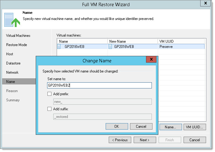

I then changed the name to use for the restored VM.

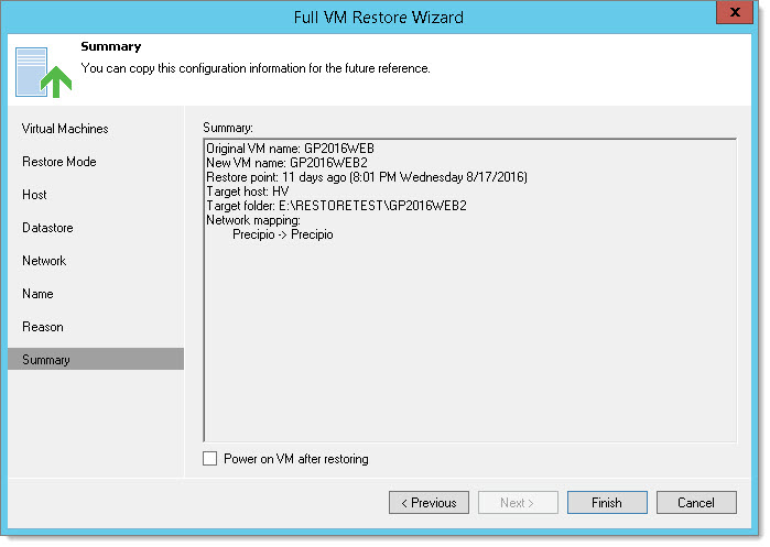

And then confirmed the options.

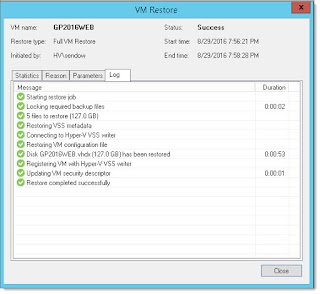

Next, just 1 minute later, it was done.

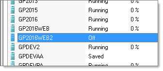

The VM was then listed in Hyper-V.
And the VHDX file was right where I wanted it.  Note that it was able to restore an 8.6GB file--it didn't have to recreate the entire 100GB VHD file.
